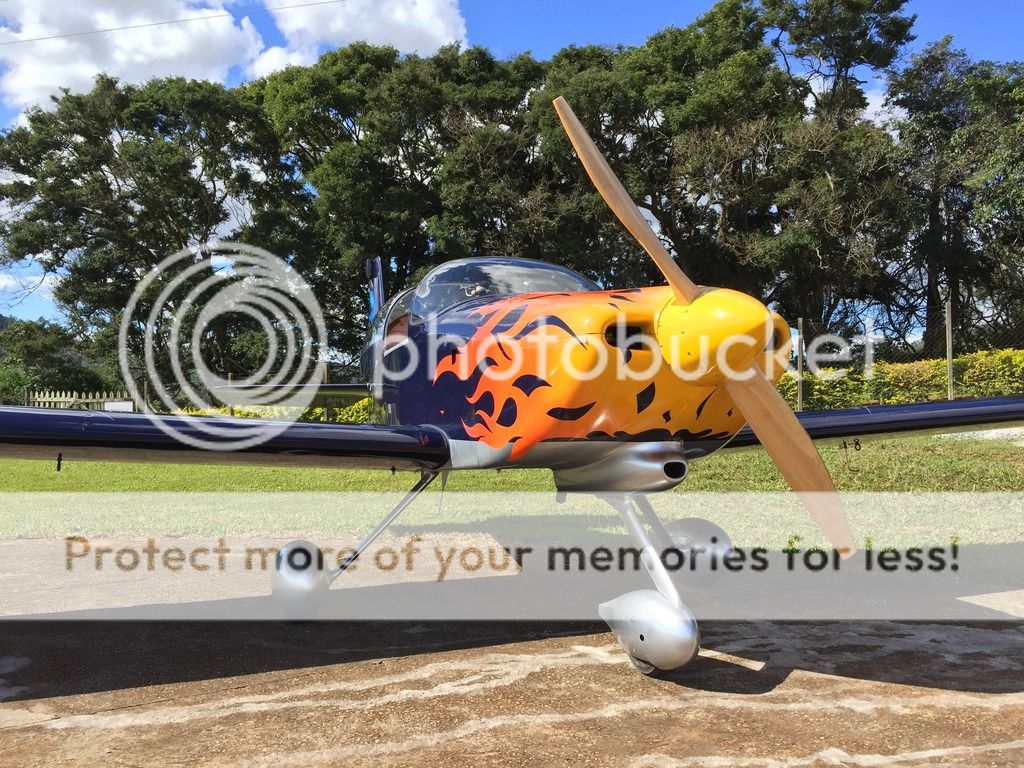

Guilhermepilot's Avatar
Guilhermepilot Guilhermepilot is offline
Join Date: Jan 2013
Location: brazil
Posts: 316
suberb prop
static 2380 rpm cruise at 6500 wot 2640 rpm 170 tas
Guilherme Plassmann (Brazil)
RV7A (Mr Flame) slow kit S/N 74285 Finished 04/14/15😀😀😀😀flying
G3X
Superior IO360
Sterba prop
TSFlightlines hoses
LR30,PRM1,C560,C510S,HS125,B350 FAA/ANAC Pilot

Old 08-04-2015, 07:23 AM
Join Date: Jan 2013
Location: brazil
Posts: 316
70/82
