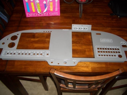

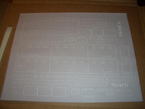

I had a set of custom dry-transfer decals made for all my lettering. The best part is that I could draw them in the same CAD program I used to design the panel. Rather than having to apply a separate decal for each switch/word/group of words, I could apply them in sections. For example, my CB panel labels were all applied at the same time and aligned with the water-jet cut holes perfectly.
This is what the label sheet looks like:
That's one of the best panels I've ever seen! And I've seen a lot.
