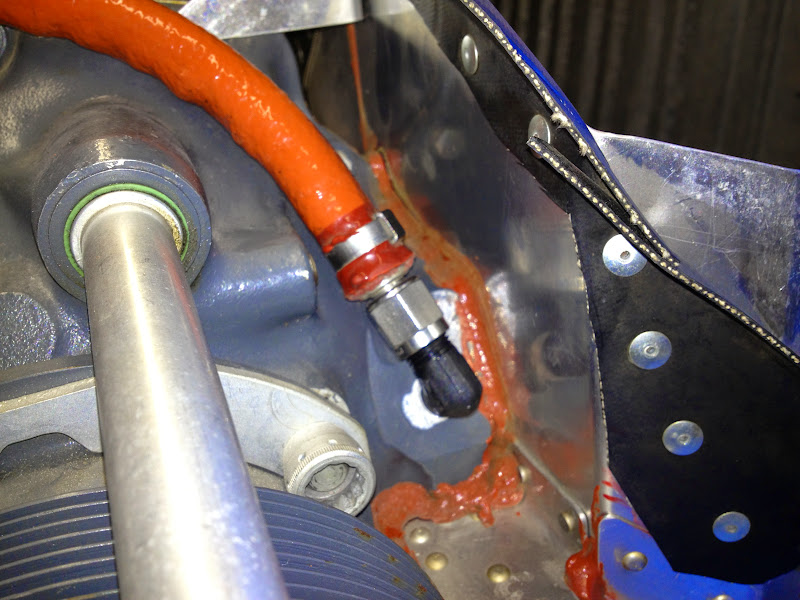

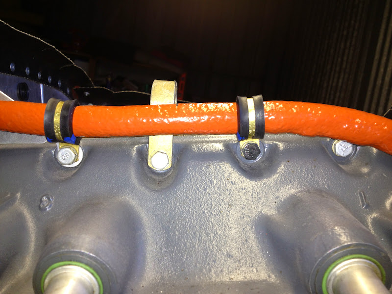

Put mine over the top away from the exhaust like this:
Has been working great so far!
No tight bends required using this route....

Smile
Great idea - I hadn't thought of that direction.
It also seems to be easier passing through the baffles.

It is a pretty tight bend at the aft side of the sump---unless you get creative.

Default Case bolts
Brantel
When the case bolts are used, what is the torque setting to put them back in and do you use slightly longer bolts due to the thickness of the clamp? Any issue with the case seal leaking?

Brantel
I used the standard bolt torque from the rebuild manual. I did use the next notch longer bolt but I am not sure that would be necessary. I added a washer under the clamp because of the relieve cut in the case. I have a narrow deck engine and they are machined a bit differently than the newer style.
No case leaks at all.
