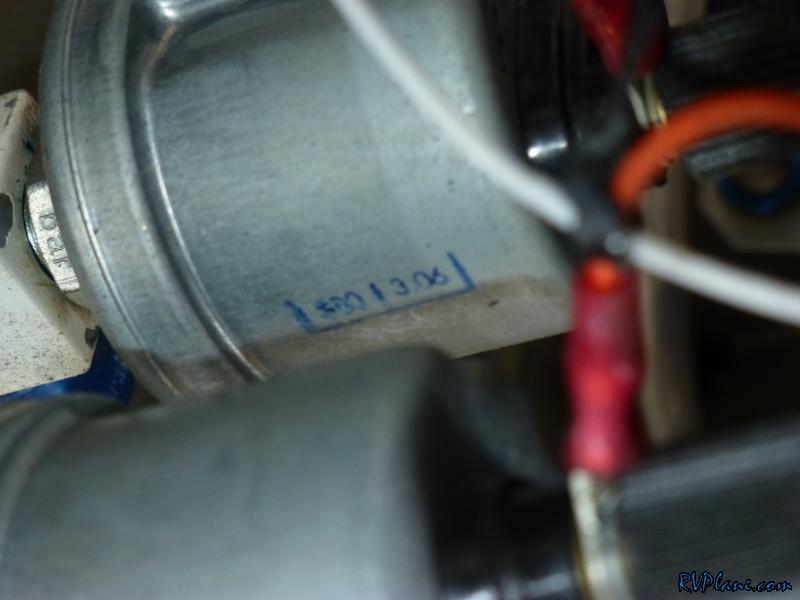

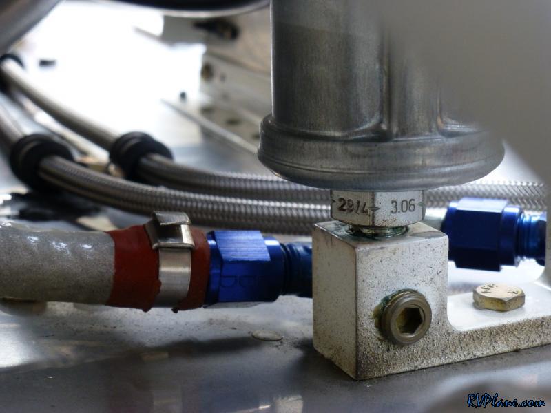

These are the markings of the 80 psi fuel sender from VDO (1/8-27NPTF, or VDO#918-360-003) - they are roughly $35 on EBay.
