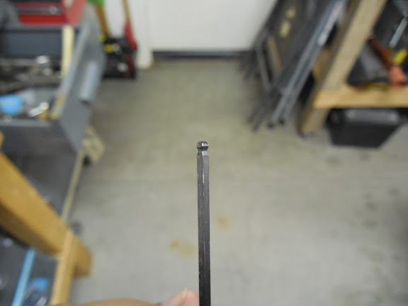

Lift and hold knob up to access the allen head screw. Remove screw completely then slide the handle off. Reverse order to reinstall.
