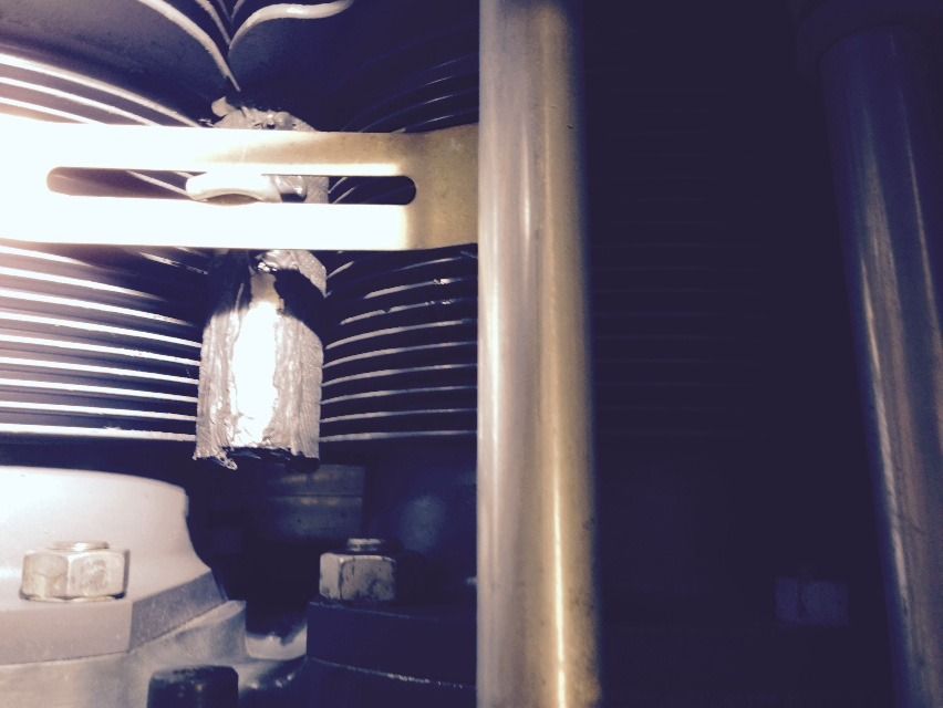

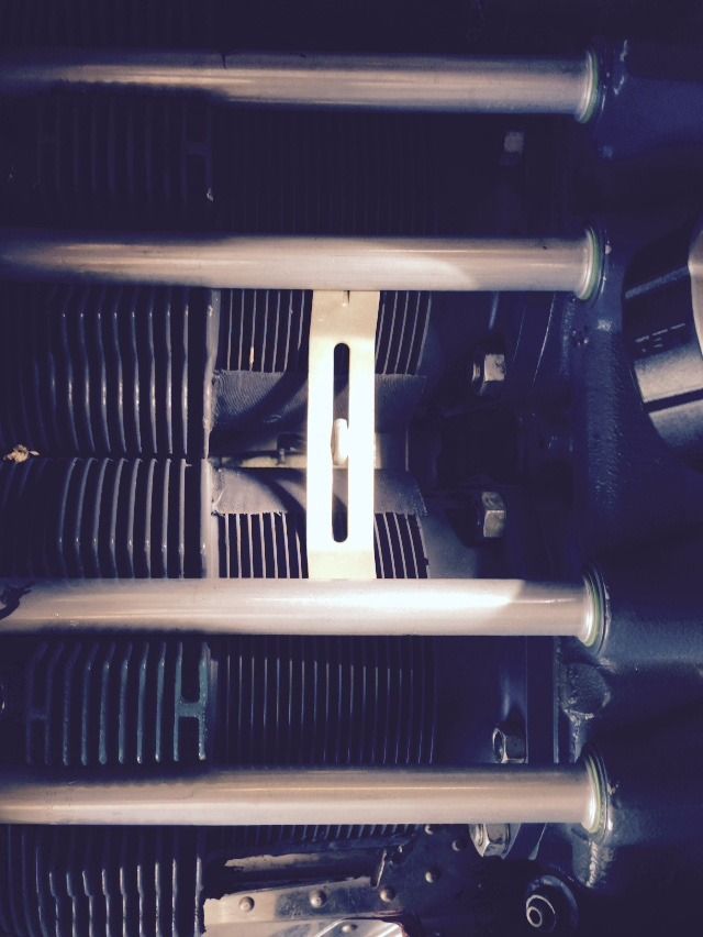

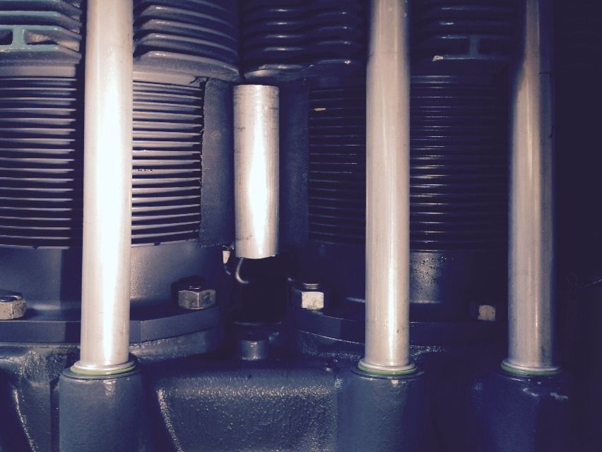

Since I'm thinking the biggest change I made to my cooling system was the baffle wraps, I decided to modify them and check for changes. I thought I might have wrapped my cylinders too much, restricting the flow through the fins too much. Here's what they looked like previously between the cylinders.
I used a 1 inch dia hardware aluminum tube between #1/3 cylinders, I pulled the baffle material (it really does stick pretty darn good) and wrapped it around the tube and super glued it. I then dressed the edges with RTV to make sure it stuck. I also trimmed up the upper rear edges of #3/4 baffle wraps and cut it flush with the metal baffling. In addition I trimmed up the lower baffles, I had some portions where the wraps were sticking 1/4-3/8 past the metal baffling.

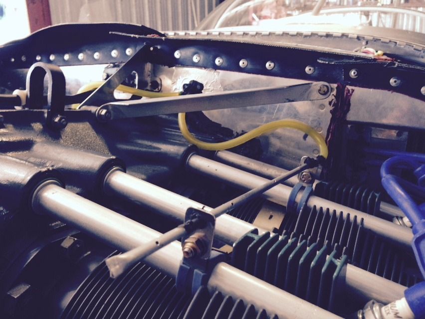

I made and installed new upper and lower Piccolo tubes, again Thank You DanH! My upper piccolo tubes are very similar in placement, my lower ones are about 1 inch lower than last time.

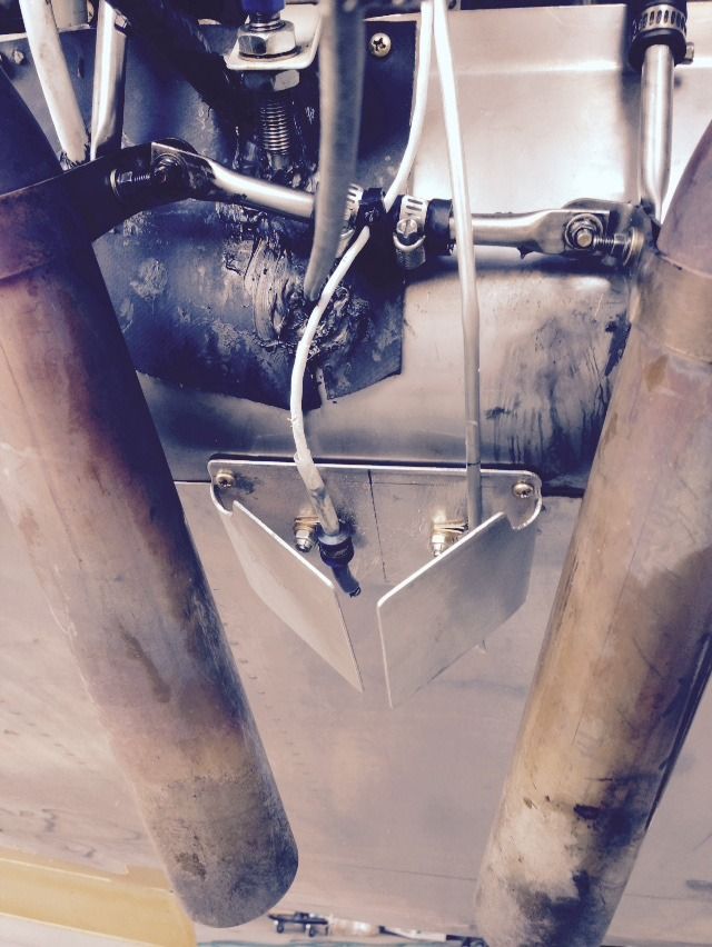

I also added an exit piccolo tube, it's about 1/2 in front and 1/2 behind the firewall. It's neighbor is a temp sensor, the v shaped wings were my "heat shield." The mount/heat shield is larger than I envisioned while making it, perhaps its affecting the piccolo tube's pressures.Tthe temp readings on the other hand seem very realistic, And.... This temp prob doo-dad is really cool----I alligator clamped it to my volt meter in the cockpit and just clicked it on when I wanted a temp reading. It told me my hangar was a balmy 88 before I rolled the airplane out, no wonder I was sweating through my shirt and on my 2nd iced tea before brunch!
Long story short, CHT's remained the same from previous flights. I think my trimming up etc let the OAT's rise 15 degrees while keeping the same CHT's. No difference from the baffle wrapped aluminum tube between cylinders 1/3 vs 2/4, everything mostly between 15 degrees CHT just like before.
I did gather some pressure and temp data from three different airspeeds, I seemed to have gained upper plenum pressure, and lost pressure just below the cylinders. I'm not sure if my exit pressures are valid, placement or bracket error my affect them. My exit air temps do seem to be valid, cold in the hangar, hot in the hanger and taxiing all had reasonable values. I have the GPS ground speeds and tracks but not sure they're relevant (about 173 knts TAS at full throttle) . Tests were in the afternoon at 3500 pressure altitude, 93-98 OAT's on the ground yielded about 79 degrees at 3500 PA thank goodness. Hot temps made things bumpy, I had an autopilot this time but still give or take a few knots. (shouldn't have much affect on pressures but they were jumping around on the manometer so it's a guess at the avg)

I see that most RV guys don't use wraps on the top sides of the cylinders relying, I suppose on pressure and turbulence to force air between the fins, however, I believe wraps help on the bottom. See some in this post
http://www.vansairforce.com/communit...9&postcount=44
As soon as the air has an opportunity after it has passed the midpoint of the cylinders, it will spill out of the fins and leave the lower fins of the cylinders uncooled. Wraps keep the air between the fins longer.
Also, consider that gap between the cylinder heads. It will pass lots of air that does not go through the fins--wasted cooling air. Same for any other gaps in the baffles.
Think like a lazy air molecule: "I do not like going through fins and tight places. Please don't make me; I get hot. I want to take the easy way through the engine."
Subject those pesky molecules to your will. :-)
I like aluminum colored silicone sealant from the home stores for filling the odd gaps. Sticks well and blends with most engines.

The wraps I made started about 10 o'clock and 2 o'clock on the cylinder and continued to the bottom of the lower baffle theoretically keeping the cooling air in contact with the fins longer. On my old cylinders I had RTV'd Van's baffle material to the lower aluminum baffle wraps to keep the fins from eating the aluminum.
Large gaps/small gaps filled. I assume you mean between the cylinder barrels, my inner lower inner cylinder baffling are sealed with a large bead of RTV. They also sit on the baffling wrapped cylinder.
I do like the aluminum colored silicone idea!
Shouldn't make any difference for measurement of upper/lower delta pressure.
Probably useless. As a very qualified aero guy explained exit pressure transition to me, given a "hole" type exit, the pressure drops almost instantly when the air passes through the hole. Here the piccolo would just average the static pressure inside the cowl, in the exit, and outside the exit.
The heat shield is pretty good, and probably needs to be that large. The aluminum will re-radiate some energy, so adding an insulator layer might be a good idea for best accuracy. A little sheet of fiberfrax felt on the wings, under some aluminum tape, will do it.

Ditch the exit piccolo, move the exit temp probe forward, a few inches inside the cowl, and add some insulation to the heat shield.
