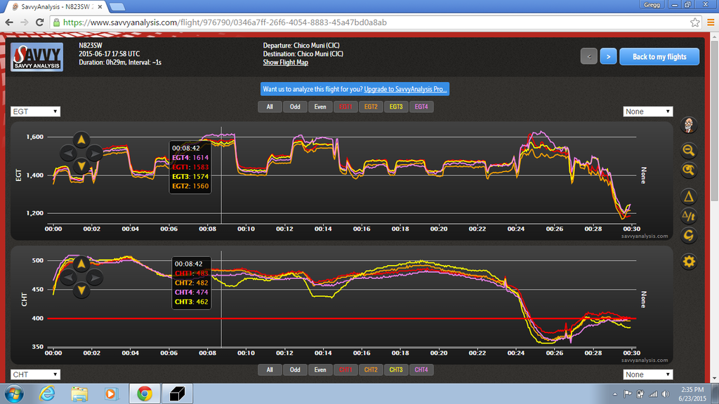

I'm posting graphs from Savvy of my last flight. The first is marked at peak EGT, the second is marked at full rich, which was 11.1 to 1 on the wide band AFR gauge and the third is just a graph of the flight with no marks. Please ignore the CHT temps -- there appears to be a conversion problem between the "J" type thermocouples on my CHTs, Savvy expects K type. Temps never got over 410.
Not sure if this helps with this discussion or not???

Always interested in flight data.

ok ... so that did not work!!!
I have them on photobucket... whats wrong???
