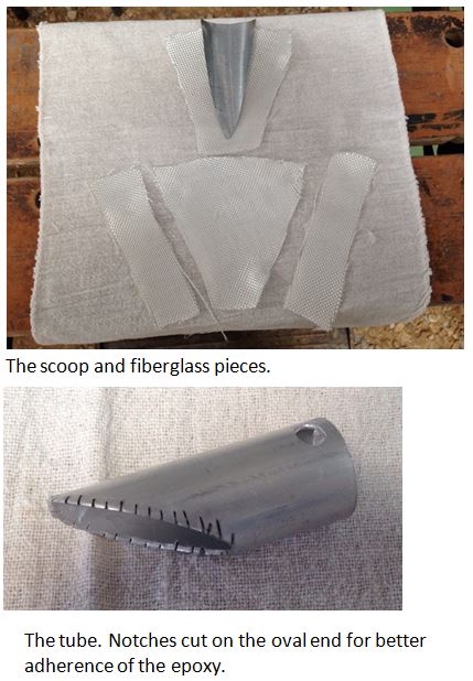

This mod is done as follows. I did NOT want to relocate the VR inside the cabin. Note that I also installed the Bender Baffle cabin heating modification so this had to be compatible.

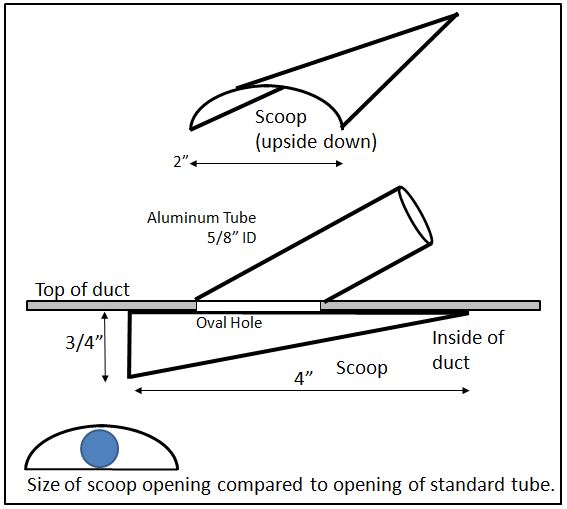

This is the basic design of the scoop, which goes in the radiator duct.
You need both a scoop and a piece of 5/8" ID aluminum tubing. I chose that because I wanted to reuse the existing corrugated tubing supplying air to the VR.

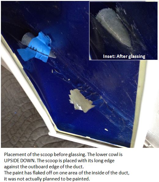

The location of the scoop has to be far enough forward to not interfere with the Bender Baffle. In this pic, the lower cowl is UPSIDE DOWN and you are looking in from the square radiator opening.
With the scoop glassed in, I cut a hole in the top of the duct that matched the oval opening of the cut tube, then glassed in that tube. I had more than enough leftover corrugated tubing from the original installation to do all this. This picture is looking DOWN on the cowl, rightside up. To the left is FORWARD. on the right you can just see the corner of the square gasketing where the duct opening mates to the radiator. That oval hole is adjacent to the front of the forward pilot-side cylinder on the engine.

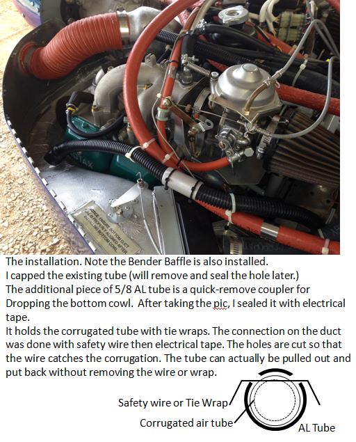

So here is the installation. The aluminum tube glassed to the duct is wrapped in electrical tape to seal the corrugated hose. Note the quick-remove coupler in the middle of the corrugated hose going to the VR - for removing the bottom cowl. The diagram shows how the corrugated tube is held in place by either safety wire or narrow tie wraps through holes cut in the aluminum outer tube. (I did not think of this - I saw it done by Joe Gores).
So, it "should" be better. After all, the existing setup has a narrow round opening that is at a right angle to the airflow it is trying to "catch." On the ground, that airflow itself comes from the SCATT tube opening which is at the very root of the prop - an area that does not produce much thrust. I had previously done a test with a dowel and yarn to prove to myself that there was a LOT of airflow at idle RPM going through the radiator part of the duct. But, how to prove that the scoop works?

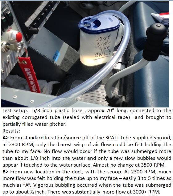

Here is the setup.
I tested both the original source and the scoop source by connecting the tubing from each to a ~70 inch piece of clear plastic tubing run into the cockpit. I tested on the ground with the engine at 2300 RPM (typical warmup idle) and at 3500 rpm. For each case I let the tubing blow on my face and also into the water container, where I could see bubbles if I submerged the tube. (I tried to take pictures but they did not come out well. I was alone.) Now yes, the 70" of tubing does increase the resistance and the flow at my face will be less than would be at the VR. But that restriction is the same for both cases.
The RESULTS!
A> From the standard location/source off of the SCATT tube-supplied shroud, at 2300 RPM, only the barest wisp of air flow could be felt holding the tube to my face! No flow would occur if the tube was submerged more than about 1/8 inch into the water, and only a few slow bubbles would appear if the tube was held touching the water's surface. There was almost no change change at 3500 RPM.
This seems to verify that cooling of the VR during ground ops with the standard setup is marginal.
B> From the new location of the scoop in the duct. At 2300 RPM, much more flow was felt when holding the tube up to my face – easily 3 to 5 times as much as “A”. Vigorous bubbling occurred when the tube was submerged up to about ½ inch. There was also substantially more flow at 3000+ RPM.
So I am calling this enough evidence for proof.

I have been interested in any progress in this area of VR cooling as well as VR options when and if I need to replace mine. I have seen several good ideas and will continue to evaluate anyone's results who take the time to post.
One difficulty is it is hard to see where your scoop and tube are installed so please consider some additional photos or drawing. Thanks

Bill, good for you doing some actual testing to prove whether it is doing what you want, but I think there is a possibility that it still is not.
Your simple manometer was referenced to cabin pressure. It is possible that the pressure in the engine compartment in the zone where the regulator is mounted, is enough different from cabin pressure that you still wont have much flow.

Here is why it is valid.
1. During the test, the top cowl was off and the canopy was open four inches "sitting on the handle."
2. I was not using the water as a manometer. I was using it as a visualization of "is air really flowing through the blast tube and if so, comparatively how much." Looking at how vigorous is the "flow of bubbles." Just like holding the end of the tube next to my face provides a "feel" of the airflow.
3. The face-test and the bubble test (for BOTH blast tube source locations) were done under identical conditions, a few minutes apart. Under those same conditions, RELATIVE TO THE ORIGINAL LOCATION off of the SCATT tube shroud, the scoop is producing MUCH more flow. Which is what I wanted to know.
4. The fact that the top cowl was off during the test has no effect because the SCATT tube and duct both get their air through the lower cowl. And if the back pressure in the overall fully cowled engine compartment is different with the top cowl on, then that would affect both test locations equally because they both "dump" into the same place.
5. I cannot come up with a scenario by which the test is in error and the original location could possibly give MORE flow than the scoop in fully cowled flight conditions. Yes, the original location will get ram air - but so will the duct. And I think the real issue is NOT overheating of the VR in flight conditions, but in ground conditions, particularly that long warmup of the oil. That "flow" from the original location against my face was very, very low. Much higher with the scoop.
In fact, I think that during ground conditions, the original location, with that metal "cap" on the VR, is worse than having no corrugated tube and cap at all. Proving that would require a temp sensor on one of the fins and testing those conditions.
So I still am of the opinion that the test was valid. And thatvthe scoop is much better for those ground operations were cooling is the worst. And logically, much better in-flight as well.

Well, just one persons opinion.... We never run out of those here do we...
(please keep in mind I wrote possibility. I am not saying you are wrong. I am simply saying that I don't think your test has unequivocally proven anything..... just my opinion)
The best way to verify would be using a true manometer with one port connected to the air supply hose and the other adjacent to where the regulator is mounted.
If there is a pressure differential between the two points then that will translate into a flow from the lower pressure to the higher pressure.
The higher the differential, the higher the flow.
