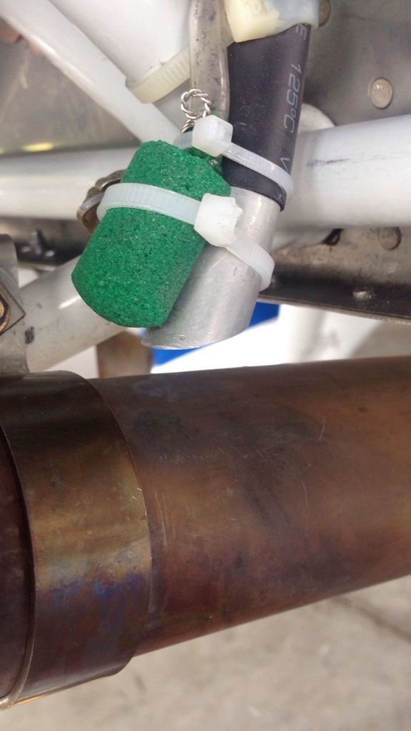

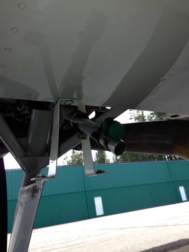

This first picture shows the location and configuration of the CC vent (along with a diffuser on the measurement line) before any changes. Basically Van's stock setup (but without the recommended slant-cut on the end of the tube -- I missed that subtle detail..).
Test Case 1: No changes, original setup
Location/HG Measurement DATA:
Crankcase: OAT 65F,171KTS,7500MSL,2600RPM,23MP,2.7"WC
Bottom: OAT 65F,171KTS,7500MSL,2600RPM,23MP,2.5"WC
Top: OAT 65F,171KTS,7500MSL,2600RPM,23MP,10+"WC (pegged the 0-10 HG Magnahelic)
From the above data I was encouraged that my scenario is matching what Tom Martin saw (however, my pressures were lower, but still relative relationship-wise), where the crankcase pressure was slightly higher than the pressure measured low in the cowl at the CC vent.

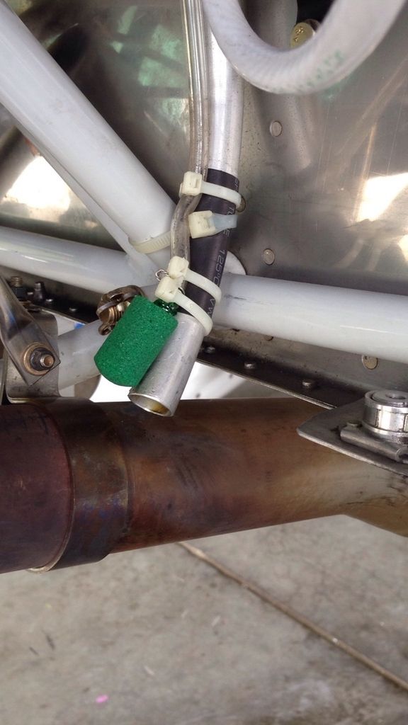

This next picture is where I chose to take a baby-step, and change the cut on the end of the CC vent tube to match Van's plans. This is the only change made between these tests.
Test Case 2: Slant cut on CC vent tube
Crankcase: OAT 72F,171KTS,7500MSL,2600RPM,23MP,2.6"WC
Bottom: OAT 72F,171KTS,7500MSL,2600RPM,23MP,2.7"WC
Top: OAT 72F,171KTS,7500MSL,2600RPM,23MP,10+"WC (pegged the 0-10 HG Magnahelic)

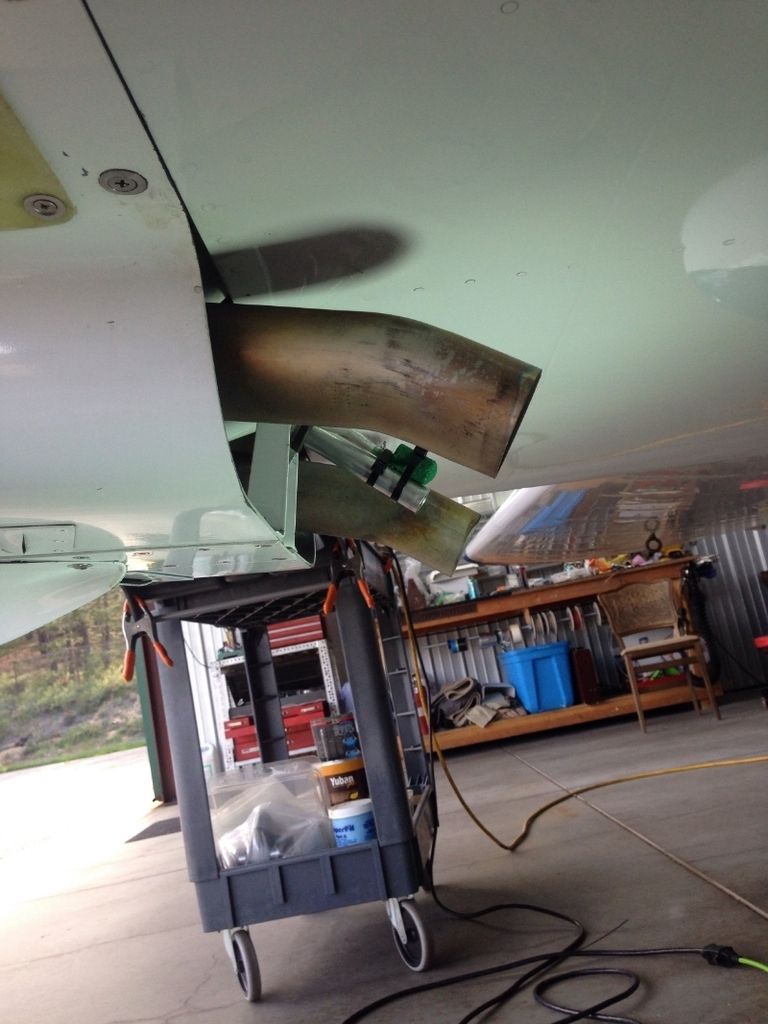

Interesting numbers here, and I suppose I could have stopped with my changes to see if the oil on the belly would be reduced simply by the slant cut on the tube end. I decided to keep testing, because I really wanted to see what would happen by moving the CC vent outside of the cowling -- which these next two pictures show....
Now, I was quite surprised by these numbers:
Test Case 3: CC vent tube outside cowling
Crankcase: OAT 72F,175KTS,7500MSL,2600RPM,23MP,-1.3"WC
Bottom: OAT 72F,175KTS,7500MSL,2600RPM,23MP,-.5"WC
Top: OAT 72F,175KTS,7500MSL,2600RPM,23MP,10+"WC (pegged the 0-10 HG Magnahelic
Wow! A 4KT increase in speed! (it actually was bouncing between 175-176KTS). I wasn't going for that, but needless to say, I was very pleased. Immediately after this test I inspected the belly for oil, and also removed the test tube from the Oil filler tube, and double-checked the oil level -- yep, same as where it started. I've since put 2 more hours on the aircraft and I am checking the oil level before/after each flight, as well as inspecting the belly. So far, still clean on the belly. In addition, I called Mr. Allen Barrett and shared these findings with him, and to get his opinion if there is any risk to continuing the testing with a negative pressure on the CC vent. He saw no reason to not continue, but was cautious to keep checking the oil levels before and after each flight. So, I will keep flying/checking, and will report back!

A few accuracy notes....
If you did not connect the aircraft static system to the static port of the gauge, the gauge pressure is the difference between cockpit pressure and probe pressure. The actual pressures at the probe locations may thus be higher or lower than indicated. As an aside, cabin air vent open or closed can also change the indication.
If you did connect the static port of the gauge to aircraft static, you could easily affect your airspeed indication; the probe hanging behind the cowl exit is probably in a lower pressure region than the fuselage static ports. That's why it's necessary to fly a NTPS GPS three-leg if valid airspeed is important to the test...the recorded airspeed data is independent of the aircraft's pitot static system.
There is a HP gain with negative case pressure, but I'd be surprised if it was enough to pick up 4 knots, in particular if it was only 1.3" H2O negative.
A valid test is repeatable.

@Dan,
Very good points. I was using cabin pressure, with the same configuration of cabin vents (between tests), but I do understand what you mean about the accuracy is in question. Between test case #2 and #3 there was roughly 3 hours time on the same day with relatively the same conditions. Both tests were in the afternoon, and both tests flown over the same area for time and distance. Test case #1 was the previous day in slightly cooler conditions.
Whether I will see a speed gain (or not) over time is secondary to my primary objective of keeping the oil in the crankcase and off of the belly, but I should be able to tell over the next 10 hours or so if this plane is noticeably faster than before.
Like I said, a valid test is repeatable. Re the speed increase, just move the breather inside and outside the exit, and fly some 3-leg laps.
http://www.ntps.edu/images/stories/d...pec-method.doc
http://www.ntps.edu/images/stories/d...ts/gps-pec.XLS
