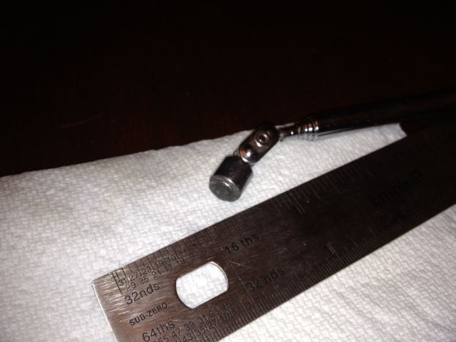

Rinsed the oil cooler and found one tiny sliver of aluminum little less than 1/32th x 1/16
I took a closer look at the filter and did the wash and rinse and see what comes out technique.
i found this:
http://i288.photobucket.com/albums/l...psa8xlqr0d.jpg
Certainly ferrous but no real pieces, it just seems like it is metal dust and just fades into a grey streak when gently rubbing it. I know the lycoming books say anything less than 1/2 a teaspoon just fly for 10hrs and recheck. I am far from anything close than a teaspoon but still....
The engine is fairly young (144hrs) can metal dust be part of the breaking in process?
