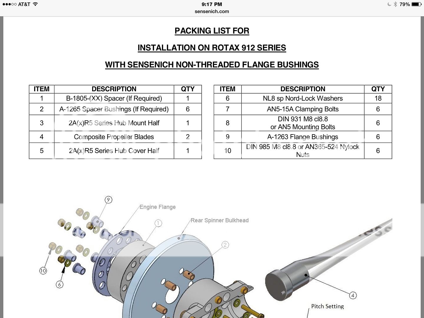

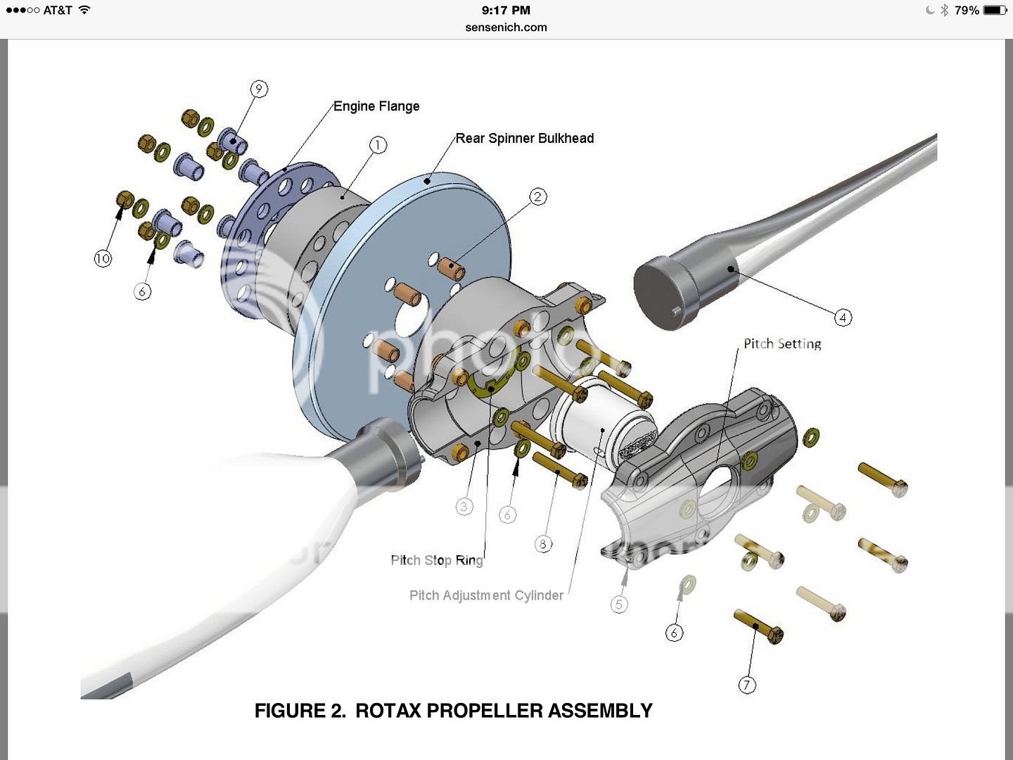

Does anyone have the actual list of hardware used on the propeller?

Ask and you shell receive.
Here is the link to manual:
http://www.sensenich.com/files/docum...1314811785.pdf
Disregard the Spacer Part #1

Thanks Jetguy, exactly what I needed.
