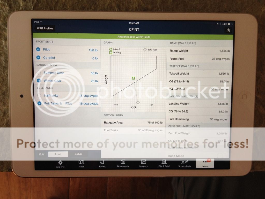

Has anyone set up their RV in the Foreflight W&B calculator? I am trying to but got stuck. It calls for the user to come up with and enter multiple forward and aft CG limit points. Each such point is supposed to have its own unique weight. How do you pick the points and calculate the weights for those points? The Foreflight instructions say to pull it from a W&B graph. I did not receive a W&B graph with our RV-6A and am working from the original W&B. Thanks in advance for the guidance.

for some of us, ForeFlight is a bit of a mystery. The power users could really teach a course on it!!!
It's very cool, constantly updated with some new widget ( but never applies to me, or Canada) but still cool.
...only.....when I entered all my W & B moments, the load envelope was UPSIDE DOWN! so obviously, that wouldn't work on my -9a!
but seriously, even if I fudged all the numbers and made them positive, or negative, or whatever, it wouldn't come out right!
any ideas welcome.
