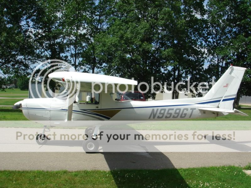

I also got frustrated with plane availability/scheduling/instructor availability when I was obtaining my PPL. I purchased a 1978 Cessna 152 that was a club plane and had a ton of hours. Insurance for me was around $600 per year and covered any licensed pilot. I found a hanger to rent at a local air-park for $200 per month. I also found a semi-retired AP/AI based there that was honest and dependable. My annuals were just about $600 every year. 100 LL was tipping around $3.00 per gallon. I was working full time back then and also building my RV-10. It was very convenient owning my own plane to train in. I loved owning that plane and spent a lot of time fixing it up cosmetically with a new interior and transparencies. It was also fun doing the basic maintenance. I ended up selling the plane for about what I had into it. It went to a flight school in MN.
David C.
Howell, MI
