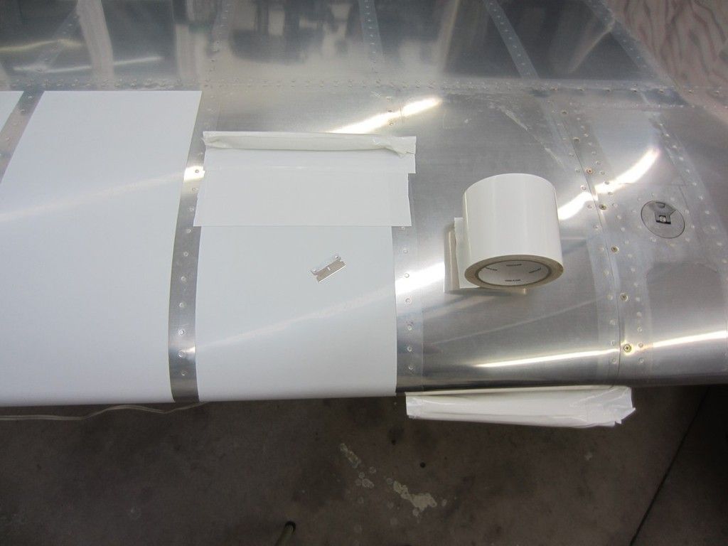

Old 05-28-2015, 08:31 PM
Champ's Avatar
Champ Champ is offline
Join Date: Apr 2012
Location: Kingsville, Ontario, Canada
Posts: 282
Default Got er done
I've been putting off getting the white plastic off one wing panel hoping for a miracle, or a couple weeks of nothing else to do - not likely. I had some seaming tape left over from waterproofing my crawl space years ago. It is tough and has the best holding power of any tape I've ever seen. Taped it to the white plastic and pretty much rolled most of it off. Some areas that were especially brittle and cracked had to be helped a little with a razor blade. The whole job only took about 4 hrs. No heat, no chemicals, no abrasives.
Just another way of doing it for anyone who still has some of this stuff. YMMV.
