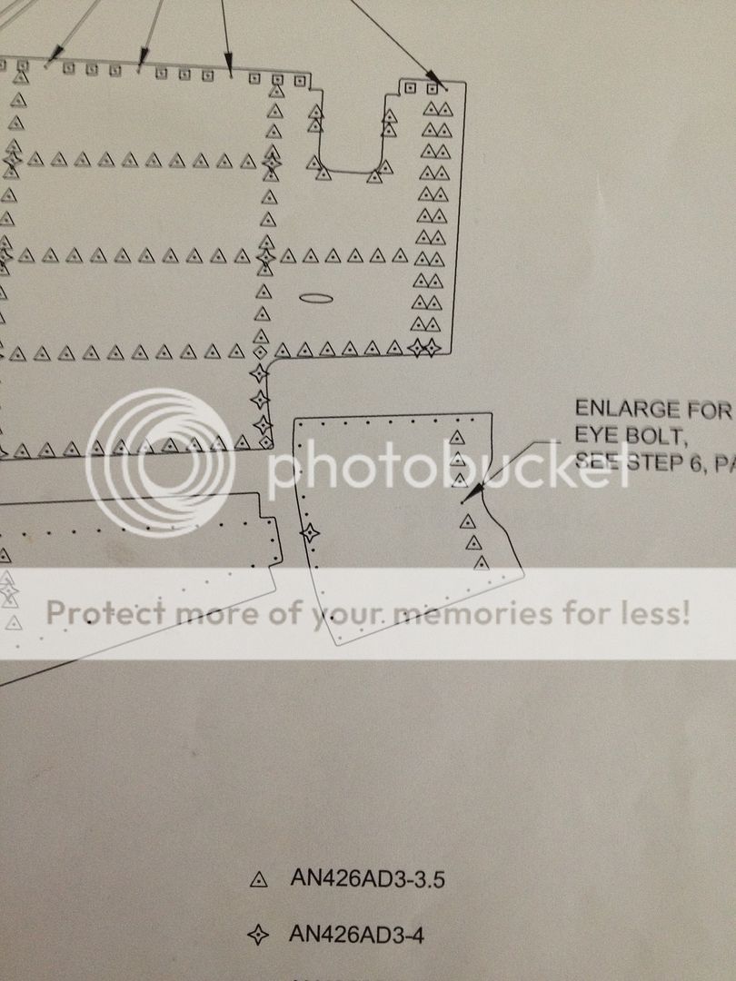

Good morning,
So my wife and baby are off to Connecticut for the weekend which means I get unlimited time to work on my RV (Until I get called out for a trip, I'm on reserve with the airlines). The only problem is that it is very unclear to me how the aft section of the tail cone comes together  . When looking at the diagram, it looks like F-1079 aft bottom skin sits inside the side skins and inside of the fwd bottom skin. I originally set it up that way but couldn't get the holes to line up with the bulkhead. Reading ahead in the manual, subsequent diagrams show the f-1079 sitting inside of the side skins but on the outside of the bottom skin. The rivet schematic also shows The F-1079 sitting outside or below the bottom skin. Any clarity here would be much appreciated. Hope everyone enjoys their Easter and or Passover.

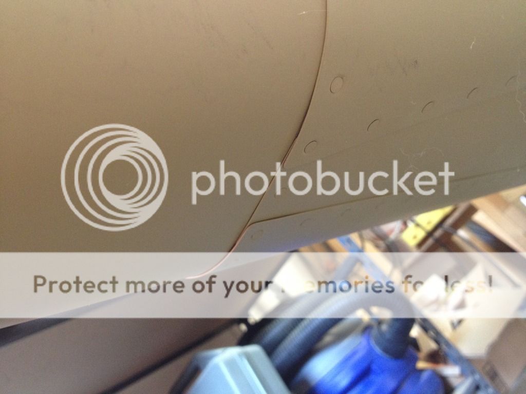

Yup. The 1079 skin is underneath all the other tailcone skins. I remember it being a PITA to get lined up, but if you just keep working with it, it'll go.
Here is the best picture I have of that part of the build:

Hey guys thanks for the quick replies. I took a picture of the rivet schematic so you can see what I'm referring to.
It shows the head of the AN426AD3-4 on the Aft bottom skin which would indicate that that piece sits on the outside underneath the fwd bottom skin and inside the side skins. That being said, the figure on page 10-8 clearly shows the Aft bottom skin inside of the fwd bottom skin and the side skins. One thing I noticed is that the diagram on page 10-8 is revision 1 while revet schematic is revision 0. I wonder if there was a change and the rivet schematic wasn't updated?

Here is a pic of mine looking forward - awkward angle, but the best I could get laying on the floor. 1079 under everything:
However, now that I go back and look at the rivet call out diagram, it is clear that the 1079 is above the bottom skin

Here's the factory RV10:

You guys are awesome!!! Thanks again for all of the quick help. Looking at the pictures you guys posted the aft bottom skin should tuck neatly inside the side skins and the fwd bottom skin. Now back to the shop to try and "massage" it all together. It's a serious PITA
