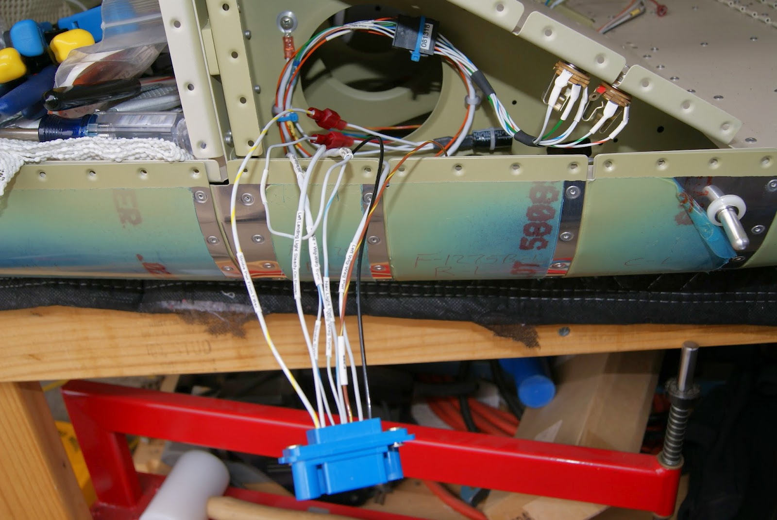

In that general area. After cutting all wing wiring according to the plans, I have about 10inches of extra wire. Have others trimmed back to suit the connectors, or somehow stashed that extra wire for some rainy day

Dave-
I made a service loop with all the excess wiring and used a couple of 1/2" long pieces of vinyl tubing to create standoffs to keep the wire loop from chafing on surrounding surfaces. If you look closely in the following photo to the right and below the black connector for the headset audio and to the right of the center line of the lightening hole ... you can see that there is a wire tie going around the wires and through a piece of vinyl tubing used as a standoff. The blue connector’s excess wire was tied down onto that existing loop.
