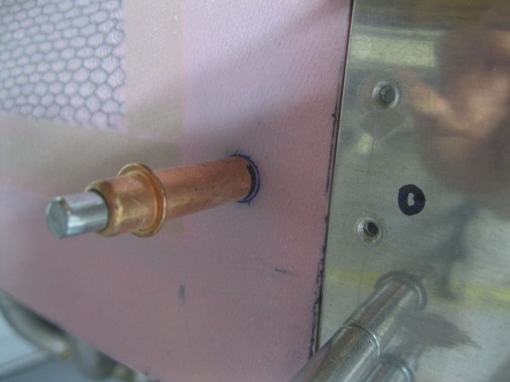

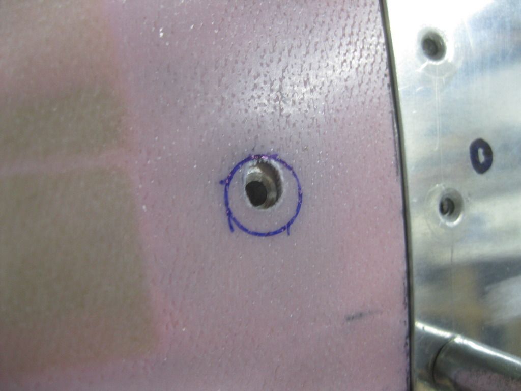

I think I found a quick and dirty method for these holes that's very simple. The pics are of my worst pilot hole, which I really buggered up with a runaway Dremel tool.
Once I modify the pilot hole enough to get the cleco into the machined aluminum spacer behind, I just trace around the base of the cleco with a fine-tip Sharpie. This circle is still a little undersized for the final grommet, but it'll give an excellent, centered baseline hole that I can enlarge with the tapered reamer.
I was lucky that I still have enough material on this hole to make the final hole without re-glassing.

Doug, This elongated hole is exactly the reason I made the drill guide out of a piece of scrap steel, also each hole was identified with an arrow to tell me which side of the hole was correct to displace the alignment pin. At this point, you should go back and look at my post in this regard. Practice on a scrap piece. If you can make a good hole with a miss-located guide hole you are better than me. Entirely possible. Hole tools wander in fiberglass.
I bet I could have used all fixed receptacles.
As always, YMMV.

Thanks, Bill. Good advice about practicing on a scrap piece. On my way out the door to buy Harbor Freight's finest $3 T-handle tapered reamer!
The pilot hole is grossly elongated, but the hole I traced around the cleco is centered, so I figure I should be OK enlarging out to the Sharpie circle. I'll do this using the Dremel (with a far less aggressive bit!) and then take over with the reamer.
