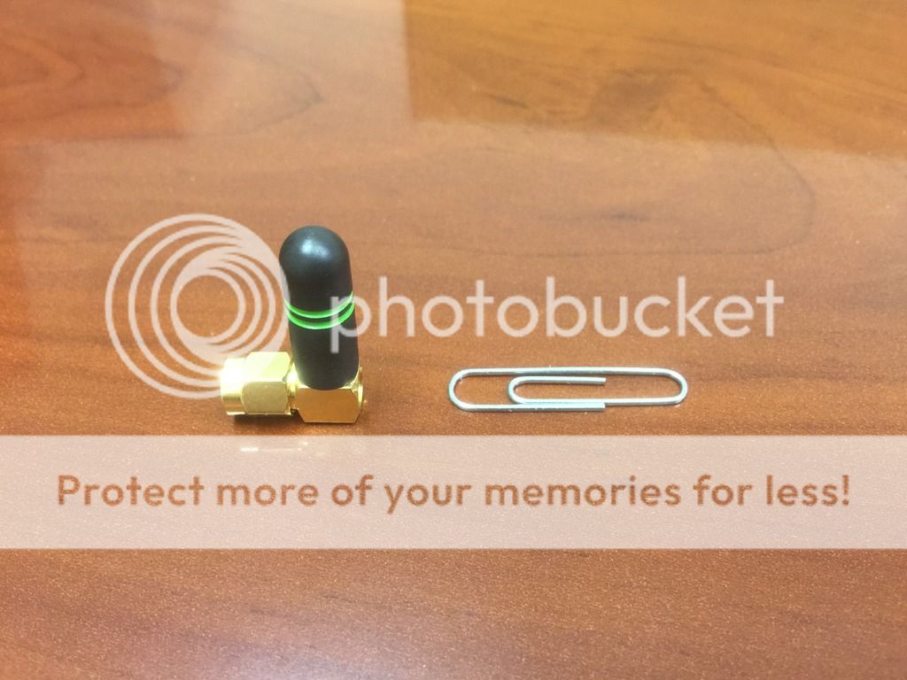

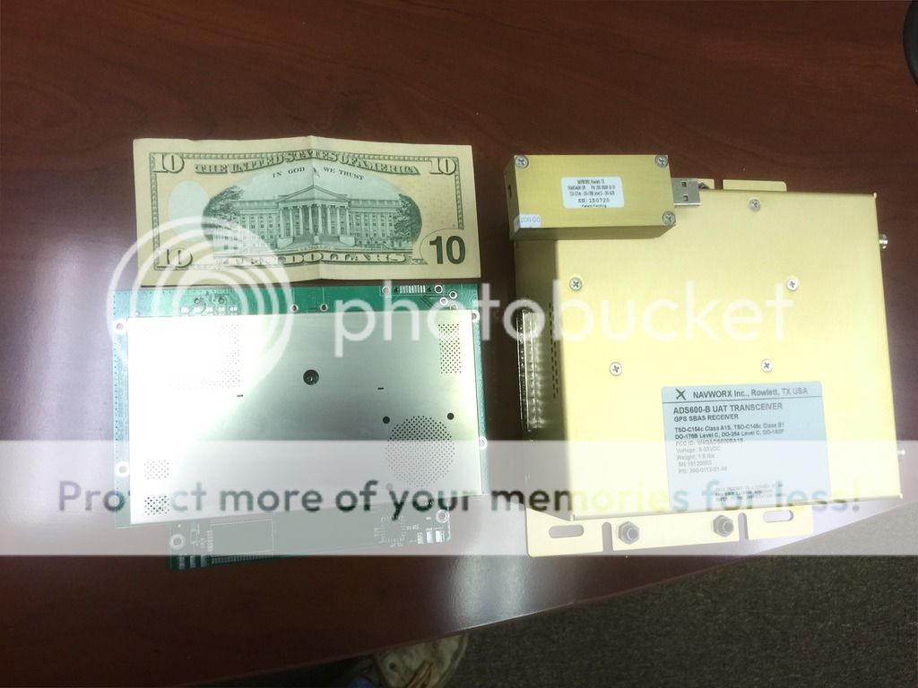

Ok here are a few pics. The Unit on the bottom is the Certified version. The one on the top is the EXP version. No, the circuit board will not stick out, this is just a mock up for pics. 10 dollar bill is for scale. its about 1/2 inch thick. Next Pic is the WIFI antenna which will be screwed onto the side of the unit, paper clip is for scale. Disclaimer: the final product maybe slightly different when they start shipping.
