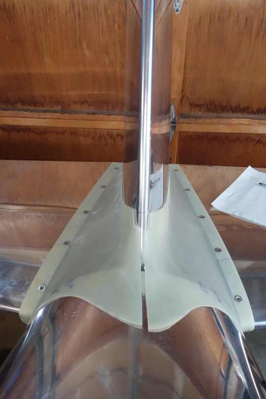

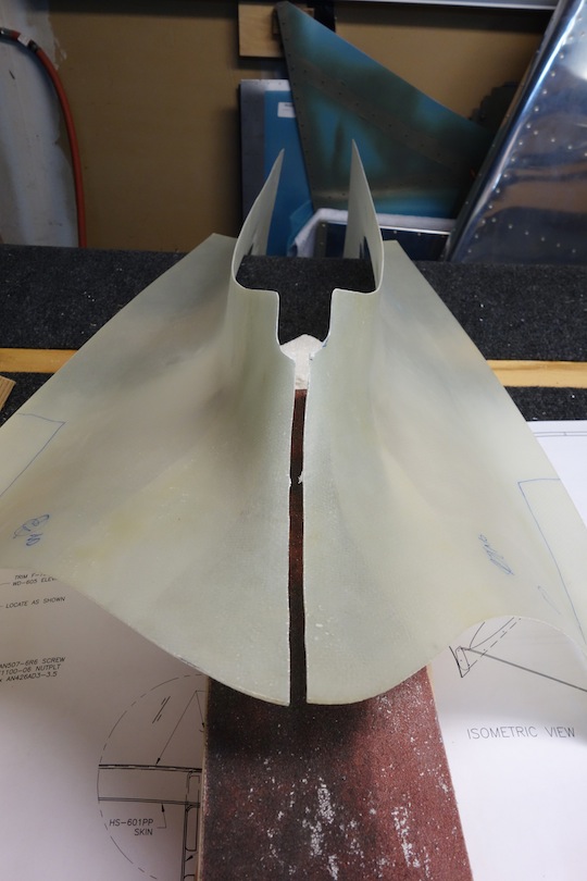

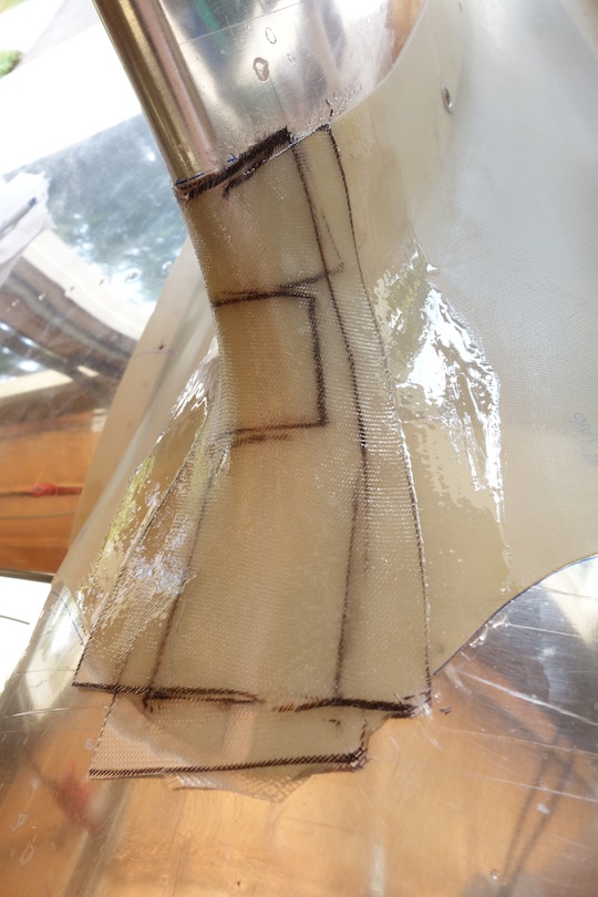

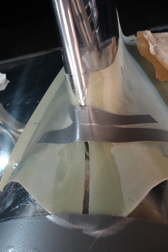

I heard about a trick to cut the Vans fairing in half at the leading edge. I did this and each side fit nicely. You then just need to fiberglass the halves together across the 1/4" gap that will be there. Pretty easy.
