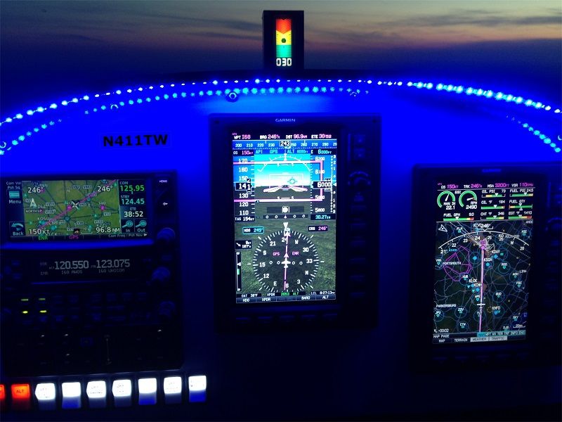

Craig-
I think it depends on the type of flying you do. When I?m flying in formation or just going out doing aerobatics I never use it. If I?m on a cross country operating in the system, then it?s a must have. I also love that it?s the exact same control head that I have in my Cirrus SR22T, so the continuity is priceless.
-Timothy
