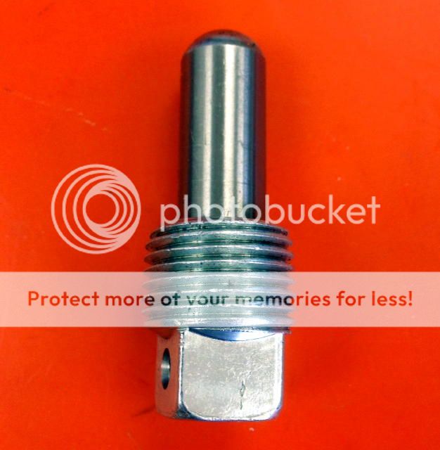

... One of these would have collected the piece, and any other steel debris from possible collateral damage if existent. These will collect steel particles in suspension that are so small, you cant see or detect them. Very inexpensive added insurance.Thanks, Allan...
Sorry for the thread drift, but personally, I don't need another maintenance item. This also has the potential for a false sense of security and could lead to a disaster if the owner or mechanic was not aware the device existed, like if you sold the plane, or your mechanic was not aware of the device. The average mechanic isn't going to know what this discreet looking plug even is.
The screen did it's job. I prefer to find my metal the old fashioned way, in my filter, with my magnet and magnifier... but that is just me....
...An oil drain plug is not a maintenance item, and one would like to think anyone changing the oil would poses the intelligence to wipe off the drain plug before re-installing it. The oil screen will stop large debris, but doe's nothing to impede small particles that can destroy an engine prematurely. These particles you troll for in the oil filter, have already been through the oil pump and done their damage to the pump in doing so. I prefer to collect my particles prior to them racing around, permanently damaging engine components and bearings inside my engines...but that is just me... Thanks, Allan
