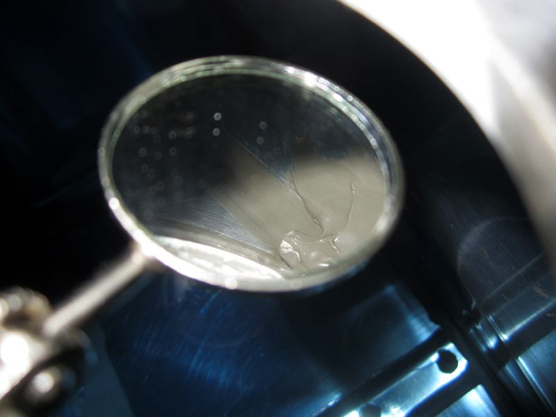

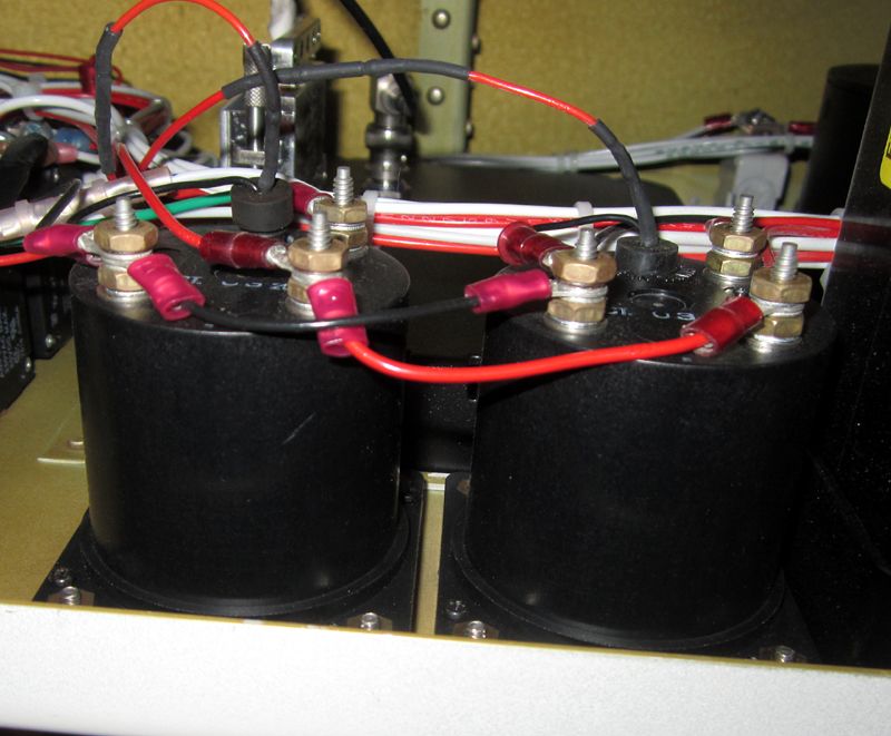

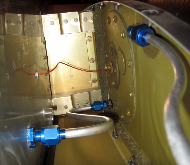

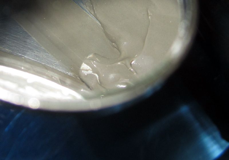

Here are a couple pics. I started at the gauge and checked all the wiring. I couldn't find anything loose. Then I took the wing fairing off and had a look around. Again, everything looked clean and dry and the only wire present seemed to have a solid attachment at the tank. I guess this is the sender's wire so the gauge can get an Ohm reading?? I wasn't able to check the resistance because I couldn't get this thread to come up on my phone at the airport. Maybe someone can describe the process using the picture I posted so it is a little more clear to me next time I am at the airport?
As far as the pressure was concerned, I separated the vent hose at the fuselage and blew air through it to the belly exit of the line. It was clear. Then I put the line back together and blew air into the tank from the belly end to the tank end of the vent tube. It was clear all the way through. I presume that the tube was completely clear (not partially blocked) based on the amount of air I put through it using my Wal-Mart tire inflator but I can't say for sure.
As far as the gauge itself, I studied it a little this weekend. It seems to come on virtually all the time (maybe actually all the time) when I flip the master switch to on. The problem seems to be when I begin to crank the engine. Sometimes it works but a lot of times, the needle drops to zero as the engine is cranking but before it starts. I'm not sure if that is some electrical problem or something to do with the shaking of the plane (or both). But at least I got a good look at everything so if anyone has any suggestions, I am now better able to understand just what we are speaking about.

I replaced the back light after I took this pic. It was loose so I pulled it out to make sure it was still connected well.

Assuming you have a volt/ohm meter, touch the leads together first to verify the meter reads correctly. It should display a really small number close to 0.0 or no resistance. Place one lead on the sender connection and one on a clean surface of the plane or ground. You can disconnect the lead at the gauge and test there if its easier. Record the value then crank the engine. Watch and see if the reading goes to 0 (short to ground). It sounds like the sender lead to the gauge is touching ground somewhere when the plane shakes.

The ground for the sender is the plate that is screwed to the tank. If you have a gasket under that plate, then the screws are the only ground path, but sometimes the proseal also shortcuts the ground path. Check the ground by touching one probe of a multimeter to the plate and the other to the tank and make sure you have no resistance.
The single wire that connects to the center post on the mounting plate is your signal wire and would connect to your gauge. I would check the mounting lug of that wire first for a loose connection. Sometimes there is corrosion under the crimp or it is just loose. Recrimping the existing lug or cutting it off (if you have some slack) and putting on a new connector could help.
Remove the signal wire at the tank gauge and use a multimeter probe on the sender center lug and another on the tank or sender plate should show a resistance value proportional to the fuel level in the tank. It should read betweeen about 30 and 240 ohms. If it doesn't then the ground is bad or the sender has failed. Do not measure the resistance with the wire still attached because it will show the resistance of the gauge, not the sender.
