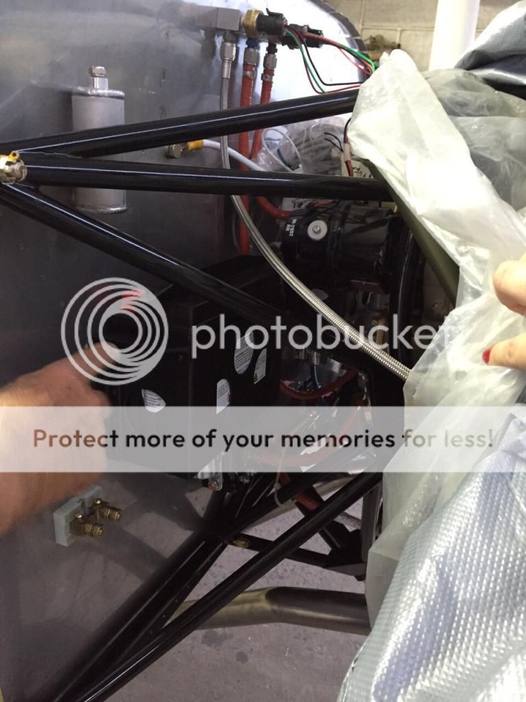

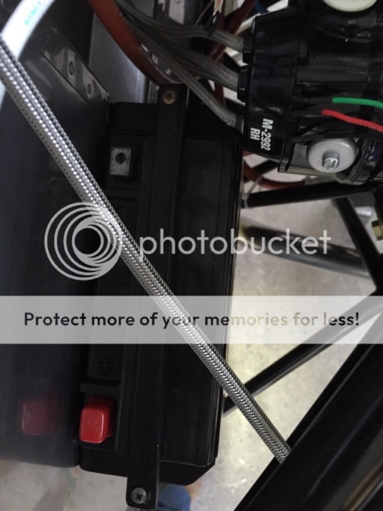

After have my Ff pretty much done I found my batt to closse to my slick magneto, there is about one inch between them! Is it a problem?
I use a yuasa same simension of a pc680

An inch should be adequate clearance. Just make sure the cables are well clear of the mag.

I was very afraid to make another hole
Om my Firewall besides the batt is atached on reiforcemts of it

Don't forget about maintenace, you will have to pull that mag at some point and the engine does move around a fair bit.

I put a bolted box so removing 4 bolts the box will came out
