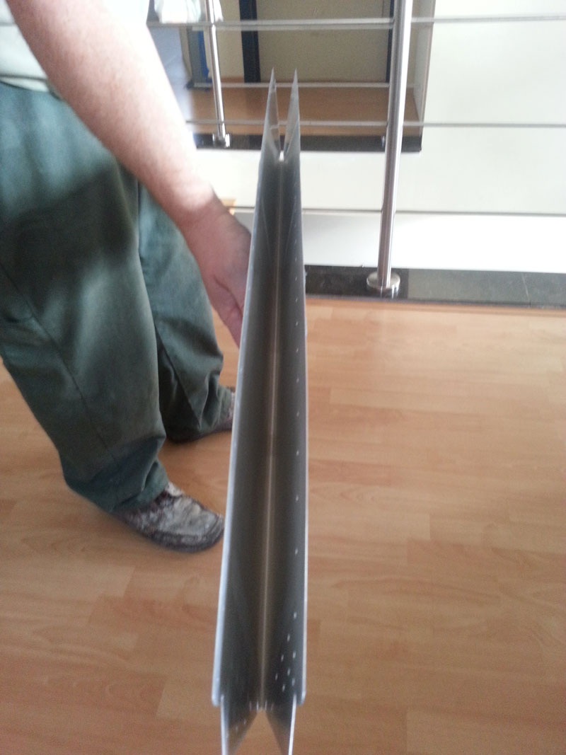

I think that I have the intended bend now. This is what I did to correct it.
Used a 0.125 inch dowel in the hinged press to bend the skin so both sides touch each other in the corners. Calm and always monitor the dowel and the skin. Do not bend all at once, but release pressure and continue.
Then I checked with a ruler to check the result like explained with the pictures on the last page of the empennage instruction manual.

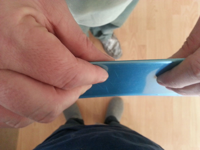

To correct the under bended area I took the skin in one hand and squeezed it between my fingers so the both sides touched each other.
Finally I put pressure on my fingers as close to the bend as possible with the other hand. When I feel that the tension is off when I release my fingers, then bend should be OK.
The final result.
What do you think? Enough of do I need to correct it more? When I now put the spar in, the upper skin is just above the spar without any pressure.

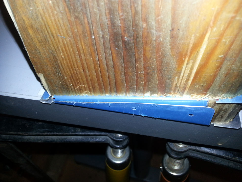

About the trim bend on the sides... The molds that are used to lock the skin in place, are they having a straight/sharp edge? The results of most trim tabs seems to have some larger radius. I was wondering that maybe beveling the side of the mold may be a good idea to prevent it from breaking?

It looks good. The test is to cleko in the spar and lay a straight edge on it.
On the tab bending blocks, mine were sharp edge sanded smooth. The plans may have a bend radius listed. You could radius the edge to the dimension but I would shoot for a tighter radius than the target or you will end up with a bigger radius than you want.
One other posted using the back riveting plate. Pretty good idea. Try it with some scrap first.

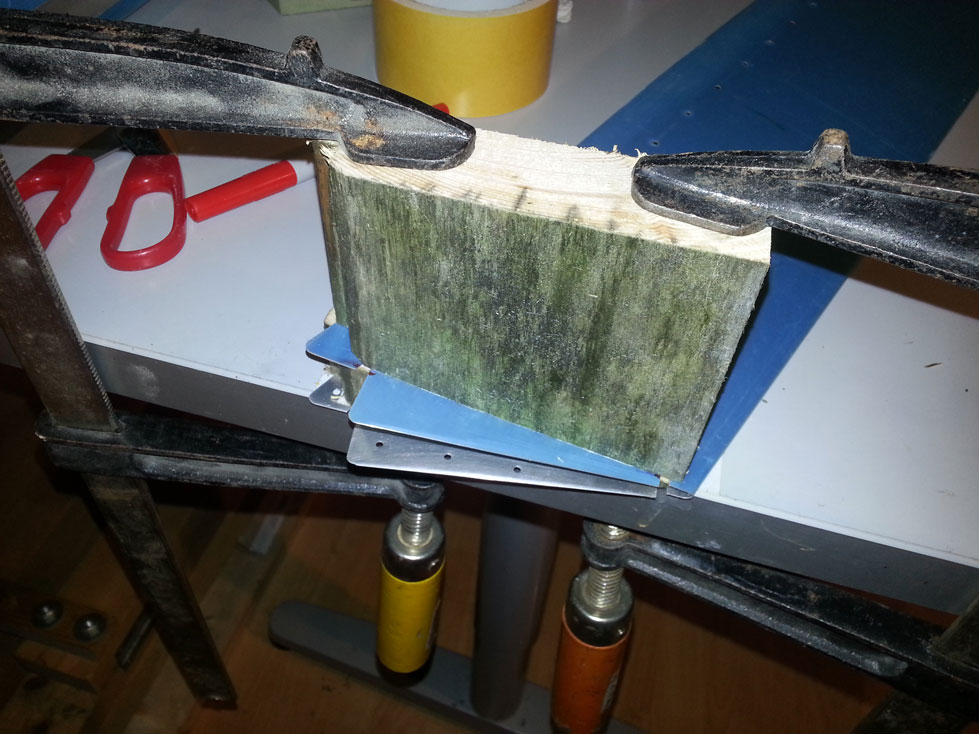

I learned by experience that it is an understatement what you told about the wood slipping around... Luckily I tried it with some scrap material.
I was planning to try your suggestion, but noticed that I have to bend the skin open to get the back rivet plate in. Did you do it before you did the final bend? I think it is best to avoid to open and close the skin too much because that's the point where I expect the trouble...

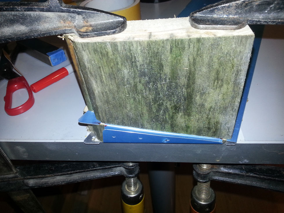

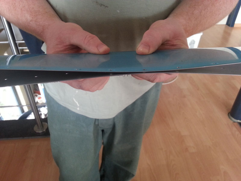

About two weeks ago I finally finished the trim. I used double sided tape to keep the wood in place. I pain to remove after completing the bend, but finally I noticed that ACETONE removed the glue very well.
I thought it would be nice to share the result. I am so happy that this is all over. This week I will prime all parts and put them together. Case closed. Thanks all for your help!
