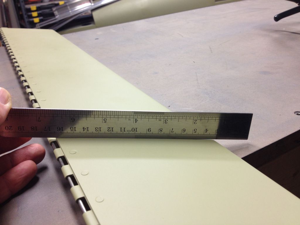

You are not even close... ditch the dowel and bend the trim tab almost flat.

Wim,
This is definitely one of the areas that is potentially frustrating. I'm a bit OCD, but I did one side 3 times, the other twice until I was happy. Bending the ends gave me fits. I used scrap wood and painters tape initially; results were ok, but I decided to try again using a hard wood wedge and carpet tape as called for in the plans - that was actually worse!! I finally bent the ends around my back rivet plate held in my table vice - worked nicely. Like Riley said, keep going. Just snapped a similar pic for comparison:
I did the starting bend with the brake as Van's suggests in the plans, but I wasn't happy with using the brake. I actually fine tuned the bend using seaming pliers - bending little by little down the length of the tab.
My pile of shame filled with trim tabs!
Jon

Hi Jon,
So basically you suggest to stop bending with the brake and switch over to the method VAN's explaining with the pliers? I guess it is 'just' putting the edge in between the blocks and compress it with the pliers. Or did I get it wrong?
LifeofReiley, the rod is already ditched...
