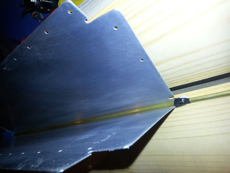

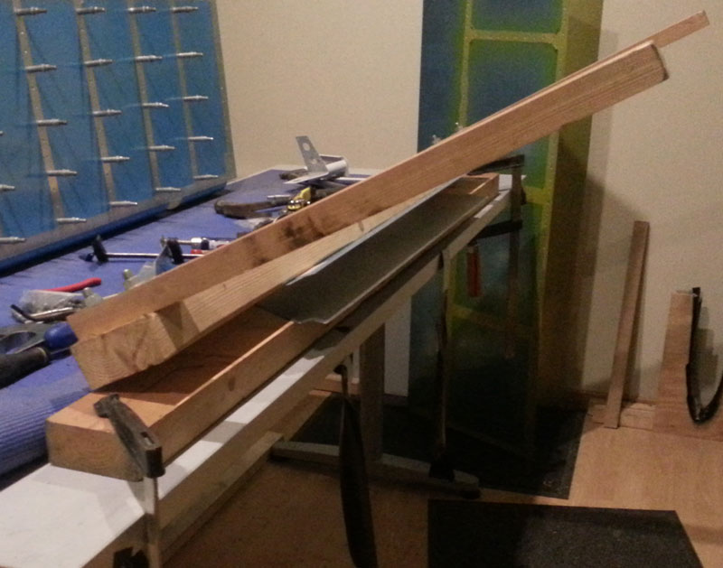

Hi,
I am currently working on the legendary trim. It appear to be one of the most redone parts in the kit. And that doesn't surprise me at all...

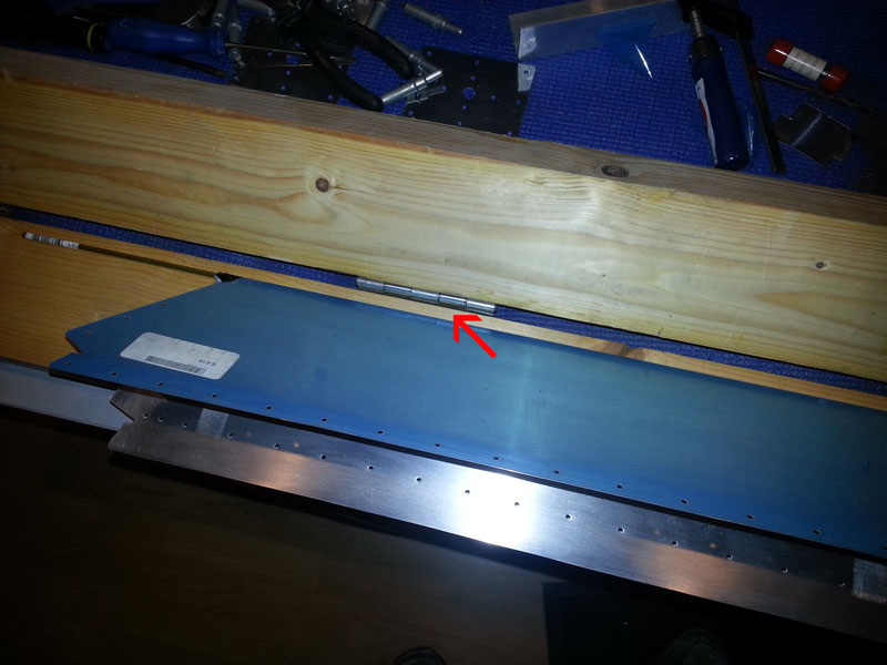

I have put a circular metal bar of 4 mm (about 0.157 inch) in the corner. This was a tip from a fellow builder. But how far can I bend this part without damaging it? I don't really dare to bend over the point that I feel resistance, fearing for a cracking sound... It is also unclear to me how far the trim edge should be from the corner on the "brake". (red arrow). I also hope that the metal bar isn't to big...
Any advise? Thanks!

It's a relatively thick bar I wouldn't use it. The trailing edge of your trim would be larger then your sharp edged elevator. A show plane judge will notice it  You can use a leftover wedge instead or nothing at all as per plans. It won't slide out if the blue plastic is still over it.

I put mine right in the corner of the brake and squeezed a littie at a time until it held the shape I wanted. If you do it in stages and don't squeeze it tight it should not crack...
I don't know about the metal bar though, I would worry it might flex in the middle and result in varying sharpness along the trailing edge. Why not try it both ways on a piece of scrap and see which turns out better?
You want the trim tab to match the elevators, so you should use the same technique for both...

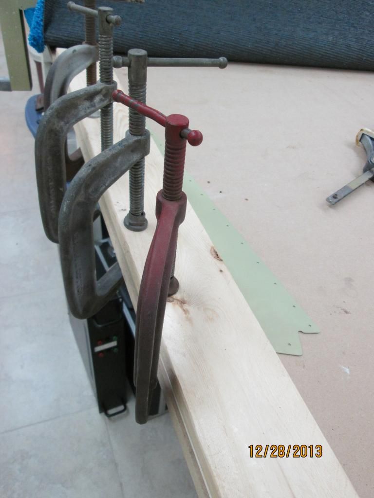

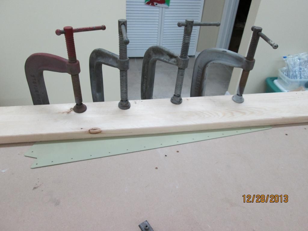

For the trim tab you really don't need the hinged press (or for the rudder and elevators actually). I just put a 1/4" diameter wooden dowel inside and squeezed the tab between a piece of wood and a flat bench top with some c-clamps. You will squeeze it flat (with the TE radius) to get the proper angle with spring-back (and flat skins). Use the trim tab spar to check the bend.

1) ditch the metal rod.
2) don't worry about a "cracking" sound - you won't hear one and you won't crack the sheet.
Bend a little at a time until it's where you want it. You'll be fine.

It looks like I need to find a smaller the rod. Maybe ditch it, but still most builders that I know of have had cracks when they didn't use one... I am stunned by the pictures where it is bend flat on the table... I continue to learn... will have another attempt when I am home.

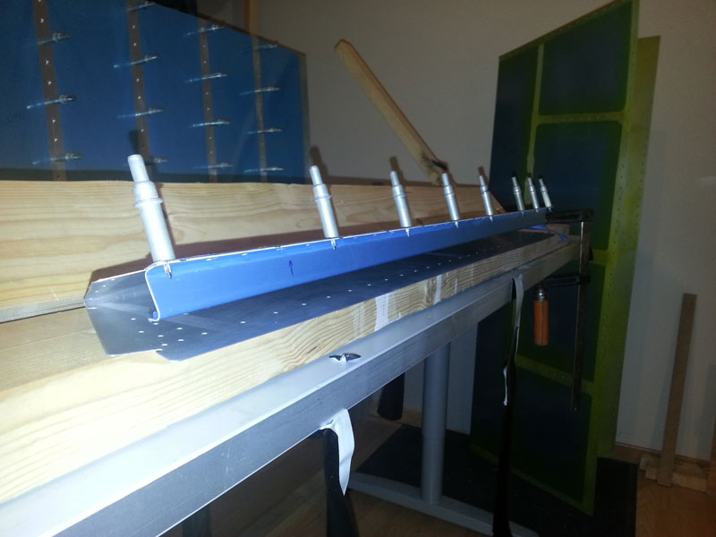

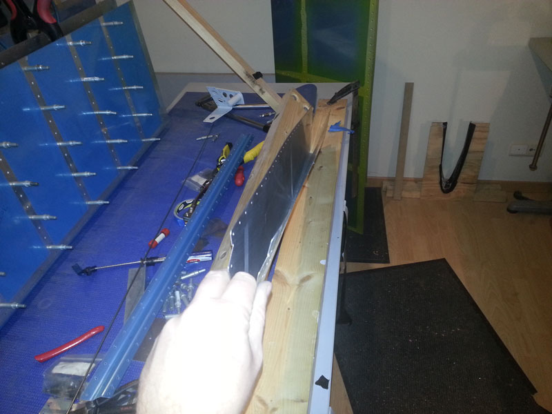

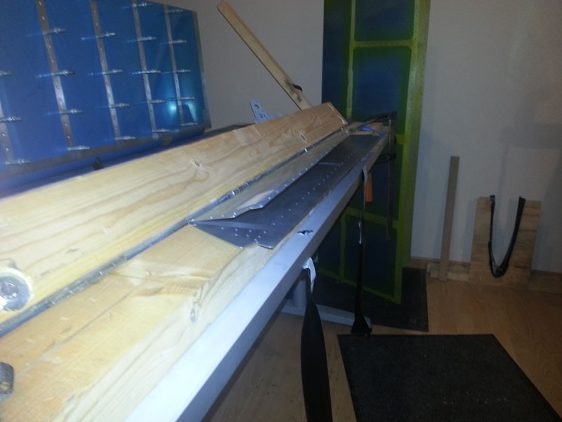

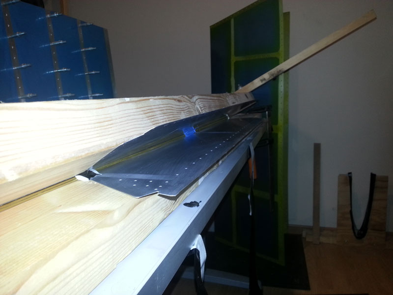

Hi,
I think that I'm nearly at the point that I can stop bending, but I notice that especially the middle section of the skin remains more open then the sides. I always used a rod of 3 mm (0.118 inches). The hinged press was nearly completely closed.
In an attempt to get the middle section correct, I tried to bend it by pushing on both sides by hand without the rod.
When I put a ruler on the skin, I notice that it is still ballooning in the middle. But as the press was closed, it is difficult to judge what should be done next to get the ballooning out of the skin.
RV9 #92188 - Working on wings

You've gotten to the hard part. Folding the ends can be a problem. Make sure the wedges Yor make / use will make the bend and not result in a bend inbound. Don't ask how I know. Just had to order a new trim pice.

Take the rod out and squeeze it. You want to creep on it till the edges touch the forward spar at rest. Take your time. Squeeze, check, lather, rinse, repeat, drink beer.
