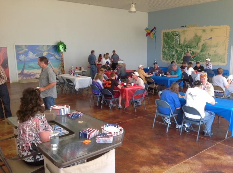

This acid stain floor takes a beating and still looks good.
Occasionally I have lost track of a dropped washer or nut, but keep the floor clean and a bright light you can always find them.

That absolutely can NOT be a hangar! Must be an aircraft slick sales office!! Where are the toolboxes, parts, drums of oil, and other aeronautical paraphenalia???

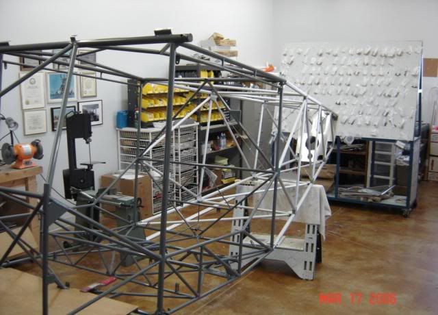

don't worry plenty of aviation being committed here. Neil has a philosophy that a clean build area promotes pride and a better quality build. So the tools and stuff get put away everyday.
Behind the plastic curtain other side of Race 81 is the 12x24 shop which houses all the tools. It where the components are built. Through the door is a 3 car garage where all the dirty stuff is kept.
Neils Rans S-6 was my first exposure to building. This is in the shop section.
the nice thing about a big empty hangar is it converts to a get entertainment room quickly. Neil hosts the 4th of July Fly-in for 8 yrs now. Life is good
