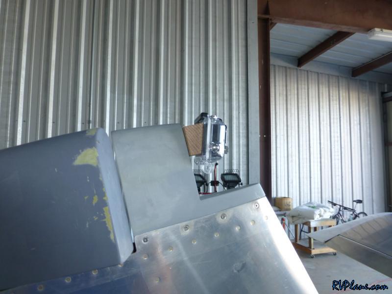

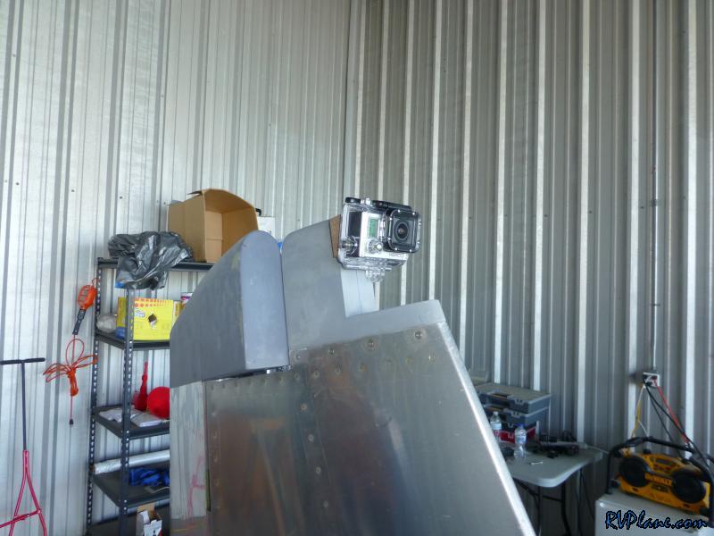

I have experimented extensively with mounting the GoPro on the vertical stabilizer. At first I made a simple mount which attached to the vertical stabilizer tip using screws:
Unfortunately, the camera footage had a lot of vibration in it. After about 6 iterations of different mounts, this is the only one that gave great results with no vibration being detected in the recorded footage
The camera perspective from the vertical stabilizer tip is great!
