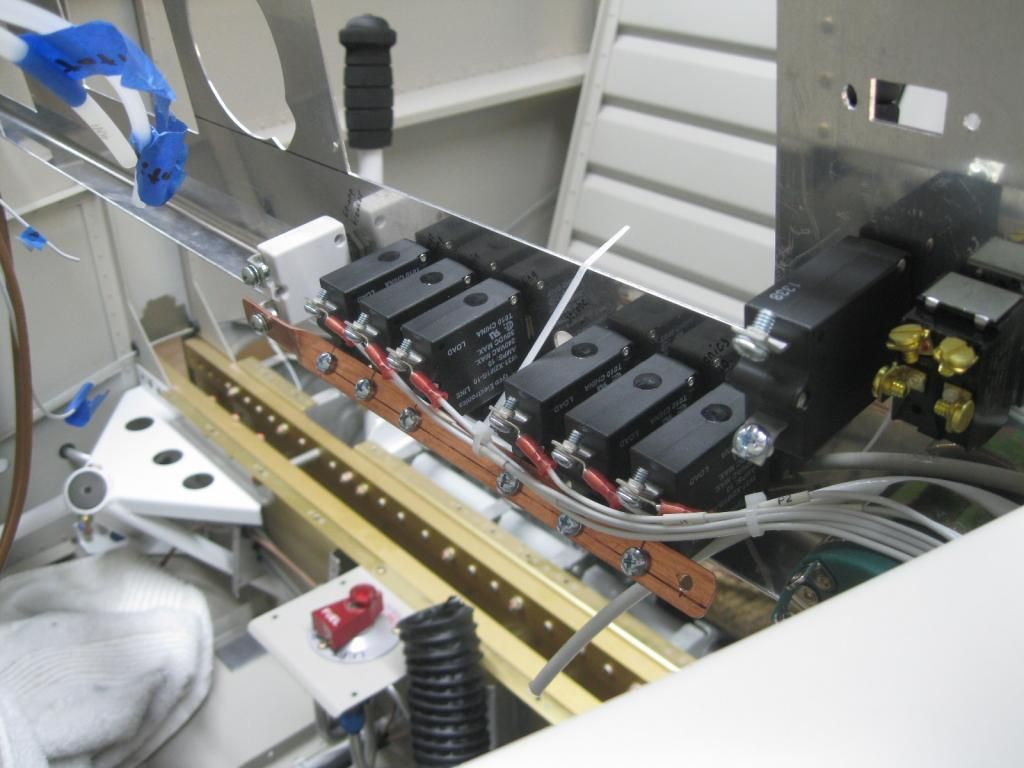

I'm using the Tyco circuit breaker switches pretty much as Van's intended. So I take it the "line" terminal is the hot copper buss bar, and the "load" feeds the lights, fuel pump, whatever. So with the switches in the proper orientation (amp values on end of toggle reading right side up, where up is "on"), the buss bar should run along the bottom set of "line" terminals. I've seen some pictures where the buss bar runs across the top. Were these a case of incorrect wiring?

if your breaker specifies Line and Load, then the battery should be connected to the Line side, and the device should be hooked up to the Load side. Unless you are using an alarm'd breaker, it really shouldn't matter which way the breaker is actually installed.

A few years back in the same place I asked Vans why their drawing showed the copper buss on the load side and the device on the line side. The person I talked with was unaware it was that way. Two electrical engineers said that would make no difference. Mine are working fine as thousands are. Do a little searching and you will earlier versions of this switch/breaker were the subject of an AD on some certified aircraft. Oh, and like everything else, some people love 'em, some hate 'em.

Called the Tyco manufacture and was told that it makes no difference. The military required the labels so they are labeled. A friend didn?t believe me, called them and got the same answer.
A note: If you install a Tyco CB switch on the same buss bar as a Tyco push pull CB one will be upside down according to the label so there you go. Larry

Thanks, guys. Looks like there's no wrong way to do it. I decided to mount the buss bar down low....plenty of clearance either way. I'm going with a combination of breaker switches and fuses, with the only pure breaker being a 60-amp for the alternator.
