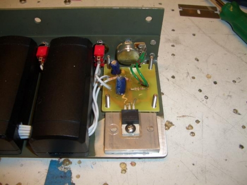

Old 01-06-2015, 05:17 AM
Join Date: Mar 2009
Location: Plano, TX
Posts: 2,088
To dim my old KT-76 and KY-97 I couldn't use a PWM (I tried), so I used a 3-amp variable voltage regulator. I am not drawing anywhere near that much current, but wanted the margin. Cost was a couple of bucks. So far it is working just great. I have a separate PWM dimmers for the LED glareshield and cockpit floodlights.
The voltage reg in on the right, the black boxes are the PWMs I made.
Front panel for my dimmers:
