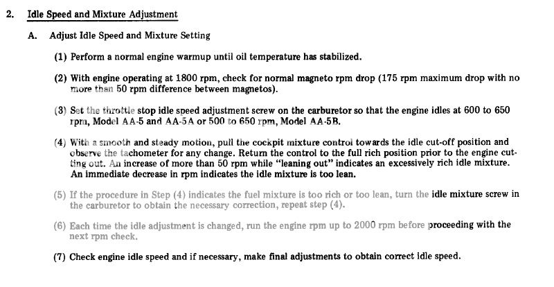

My aircraft manual says to do the 50 rpm rise idle mixture check from the idle speed. It also says not to actually let the engine quit.
The idle speed for your particular engine model should be in the Lycoming Operator Manual. The first idle speed number above is for a O-360-E2G and the second for a O-360-A4K.

If the OP's engine doesn't idle smoothly at 500-650 rpm as stated, how could he tell if there was a RPM rise before cutoff?
Also the AA5 aircraft manual suggests to adjust idle mixture with the engine running and repeat the test?

The two (idle speed idle mixture setting) are related, adjust as necessary. I would adjust the idle mixture to see if I could get a smoother idle.
And yes, adjust while running is the factory manual recommendation.
If you don't adjust while running, at least do the run up to 2000 rpm bit before checking any adjustments.
