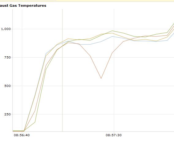

I've been chasing an issue for a few months now, thought I found the smoking gun a couple of times but alas it still happens.
All was well for first 60 hours, then this issue showed up. If I let the plane sit for 12 hours or more I get an odd occurrence on start up. Crack throttle, mixture rich, boost pump 5 seconds... It fires up normally, runs great for 30 seconds or so then a cylinder drops off. Idle goes up a couple hundred RPM, EGT on that cylinder plummets, CHT starts falling and the engine shakes like a dog after a swim. 30 seconds or so and the cylinder comes back and she runs great from there on out. Normal run up, perfect in flight. Hot starts are normal. Switching Pmags off one at a time has no affect, EICommander says Pmags running normally. It only does this after sitting overnight or more.
The cylinder that drops out isn't always the same cylinder. Has been #1, #3 or currently #4. This leads us to believe it's fuel related and I'm getting air in the fuel line somewhere and that slug of air kills a cylinder until fuel arrives. What I am struggling to wrap my head around is why only one cylinder drops out when this happens, why it changes cylinders and why I'm not seeing any fuel leaks anywhere.

Another data point that I forgot to mention. Once the cylinder drops , on occasion....another cylinder will drop out. That leads my mind to a fuel issue which is why I've been focusing on that area. I could be completely wrong, but I can't think of how anything but a fuel issue could switch cylinders so quickly, and leave the EGT's and CHT's dropping.
What is the failure mode of a fuel divider problem? Can a servo put air in the fuel line? How about a mechanical fuel pump? Or, am I chasing fuel when the problem is elsewhere?
I admit I struggle to understand how a 100 hour overhaul would have exhaust valve issues across several cylinders. I am far from certain though, as at this point I'm ready to believe just about anything...but wouldn't EGT's go up or at least produce some heat if an exhaust valve stuck open? Mike Busch's Savvy Analysis swears it is not sticking valves. Here is what the EGT's look like when this occurs:

After all the sticking valve suggestions, I went to the airport to rule it out. I started the plane.....confident it was not a cylinder issue because it wasn't always the same cylinder that dropped. When a cylinder dropped, I shut down and climbed out. Rotating the prop through...one of the cylinders had no compression.
"You gotta be ****'n kidding me...."
A few rotations later, heard a click and the compression was back. Repeated the next day...same result.
A sticking valve.
Prior to the problem showing up I had changed from break in oil to Exxon Elite. A quick google search for Exxon Elite sticking valves found a few pilots had experienced the same issue when they changed to Exxon which went away when they switched to something else...so I put Aeroshell back in. The next start, the cylinder dropped but only for a couple seconds. The following start and every start since then......smooth as silk. I dont know why, but my engine hates Exxon.
Brown Avaition who overhauled the cylinders had previous to my posting here said there was no way it was a sticking valve. Mike Busch's Savvy Aviator analyzed my G3X data and said it wasn't a sticking valve. I was sure I was wasting my time when I went out to start the engine to check for a sticking valve....and we were all wrong.
My heartfelt thanks for those who helped. I was down a rabbit hole chasing what I thought was the problem (fuel)...and would probably still be there if I had not posted here. It's been two weeks of cold starts and flights nearly every day with Aeroshell....and not a single hiccup. With Exxon it dropped a cylinder on every cold start without fail. I don't understand why, but this gift horse's mouth is staying closed.
