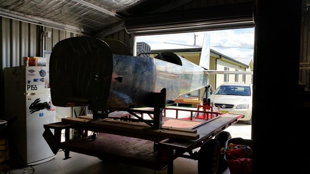

Here's how I moved my 8 to the paint shop to spray the inside! Don't forget that if you tie the back down around the tail spring or over the tail make sure the vertical stab rear spar attach point (on the fuse) is supported with the vertical stab in place or a makeshift post!
