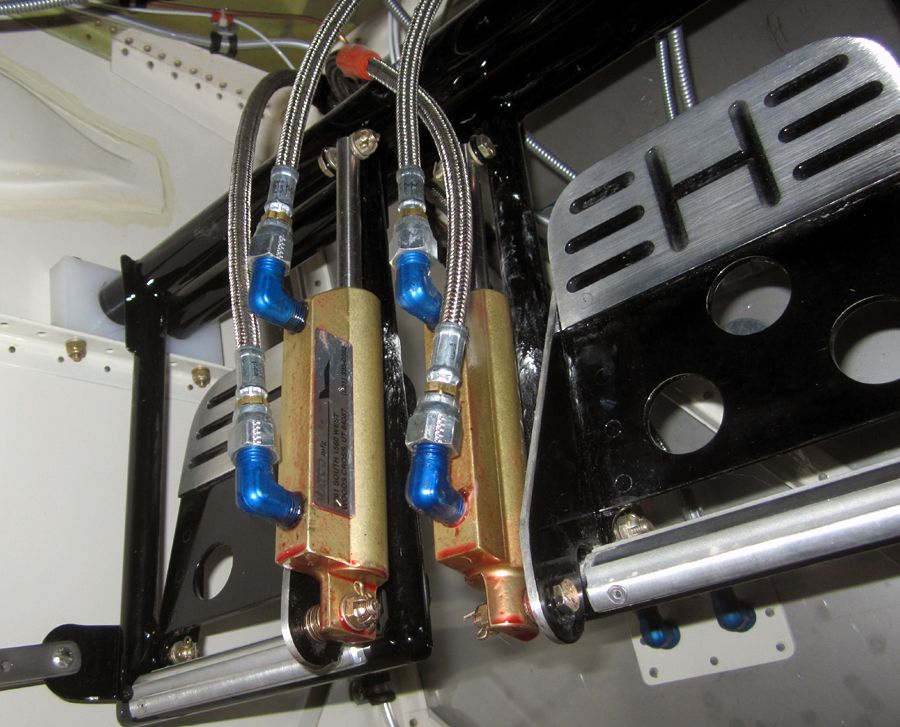

They look nice John. What are the blue fitting made of? I am in the process of trying to figure out how to fix my brake gremlins on my 7 and my brakes look exactly like yours (hoses and fittings included). The reason I ask is that a friend of mine thought I had aluminum fittings and he said he fixed his cylinder leaks by replacing with brass. Just one of the 50 or so suggestions I've read in all the leaking brake threads.

Andy---do you have leaks or a spongy pedal?
The blue AN fittings are AN822-3D's.

Pedals are very firm but the lower fitting is surrounded by fluid. It may be running down from the upper fitting though. Either way I have some o-rings and thread sealer coming. Thanks.

The blue AN fittings shouldn't be leaking. A potential fix is to use some DEL 37 degree flaring seals.

Andy ... When I was playing around with the poly brake line tubing Van's supplies, I noticed after the brass insert is installed the diameter of the poly tube expands slightly. When the compression fitting sleeve/nut are slid over the brass insert, it can result in a very tiny shaving of poly being scraped off the tubing. I saw this happen a couple of times.
Once it was just a very tiny amount that would have not interfered with the mating surfaces ... however, once I actually saw a small sliver of the poly extend over the mating surface of the compression sleeve. Perhaps a small sliver of the poly is on the mating surface of your leaking compression fitting. In my case it was quite transparent because it was so thin and subsequently hard to spot ... but it was there. This may be your issue ... you may be lucky and be able to fix it with good light, a magnifying glass and a tiny pointy probe.

Thanks for all the support guys. And sorry I hi-jacked your thread John.
For what it's worth, here is a pic of my interior problem. The right brake itself got pretty noisy today too. It used to just complain a little when I was dragging the plane in or out of the hangar. Today it actually groaned pretty good (but intermittently) while I was braking on landing. Not a condition I am comfortable with. I am going to try to get someone to help me at least change the o-rings and add some permatex to the threads. And then I can tackle the groaning. I don't really know that much about the brake system, other than what I can deduce from the comments here and in other threads. I imagine I need to drain the reservoir and the lines, change the o-rings, and then refill and bleed. I just have no idea how to actually do any of those things.

It appears as if the leak is coming from the NPT thread on the AN fitting. I can't really tell, but if there is no thread sealant in there, you will want to utilize one when you reassemble it.
