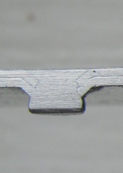

1. Deburring the inside diameter of the hole makes it easier to get the rivet in. It eliminates a loose chip of aluminum that could interfere with a tight fit of the rivet to the riveted pieces. Deburring the face of the hole makes it easy to get two pieces to fit tightly against each other.
2. Yes, chamfers will be smaller on thinner sheets. How big?? ... I know one when I see one. Perhaps the depth of the chamfer is 10% of the plate thickness.

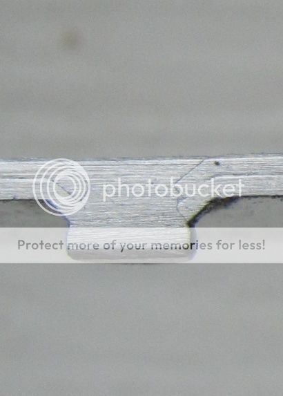

3. Mentally draw a cross section of the riveted joint, or carefully saw one in half on a bandsaw. The rivet has been shortened by axial compression (from driving or squeezing) which caused the diameter of the rivet to expand and fill the entire void volume of the hole, assuming the hole was appropriately sized and the rivet properly driven. If the holes were chamfered there will be a chamfer under the factory head and the at the shop tail of the rivet. Without chamfers these transitions will be very square, perhaps sharp corners, which are well known to be fatigue initiation sites. If there is any misalignment between the two parts, the same sharp corner geometry will exist at the interface between the two (or more) parts.
Most aircraft structural joints have some factor of overdesign in them. Perhaps an un-chamfered hole will provide adequate life. But every designer of aluminum aircraft structures is assuming the builder will chamfer the hole in order to produce a joint that has design strength.
I have not seen the documents that quantify the degree that an un-chamfered hole compromises the strength of a rivet, but it is logical to think that someone in the aircraft industry has studied this, and concluded that the additional effort of chamfering both sides of every hole was justifiable.

One item not mentioned yet is the fact that the factory head of a 470 rivet has a 0.010 radius where it meets the body of the rivet.
The small chamfer will help the rivet seat better in the hole and not cause a stress point if the rivet head radius is forced into the sharp edge of a non-chamfered hole.

paul mosher got it right, and here's a more detailed description of why to remove burrs inside holes, even if the fastener fits. A burr there will act as a sort of small spring between the fastener and the hole, reducing the shear stiffness of the joint, for low levels of load. That means that for that load level, the adjacent fasteners are having to work harder. And this slightly but adversely affects their fatigue life.
It's not something the designer can predict or allow for, since it's an uncontrolled artifact that's being left in the hole.
You don't want to chamfer holes unless necessary for the fastener, as paul said, because that reduces the bearing area for the fastener to bear against. That directly reduces the strength of the joint. With driven rivets, you can expect some filling in of the chamfer space with rivet body, but it might not fill the space, and anyway, you have no control over it. So minimize chamfering on holes.
