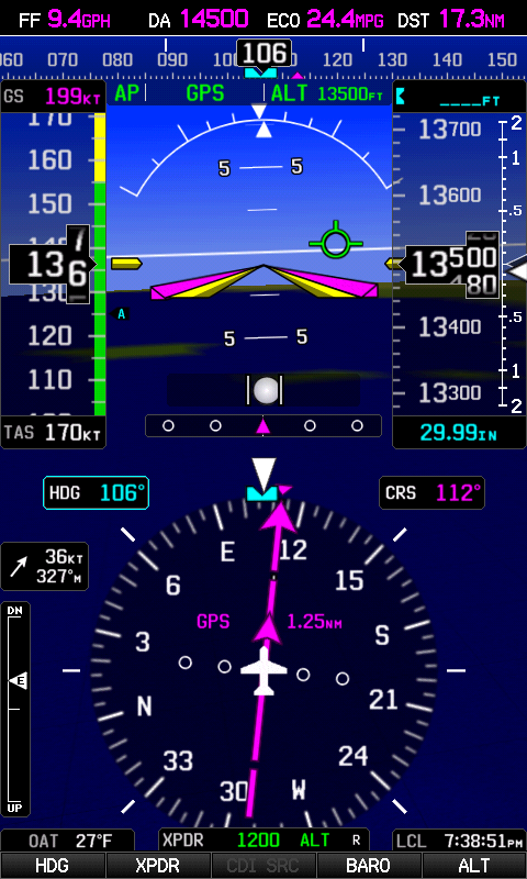

Pierre, Unless the headwinds are significant, a flight of that distance should be no problem in an RV-10 with 60 gal. fuel. If possible, fly high, and if not, drop down low and use moderate cruise power. Here is a screen shot from our recent trip from Yellowstone back home to Pennsylvania, crossing Lake Erie at 13,500'.
Note that the MPG shown on the Garmin is statue miles and based on ground speed. True airspeed, of course, is knots. I've repeatedly verified the true airspeed with four way GPS runs, and find that it reads about 1.5 mph slow at 8000'. :-)
