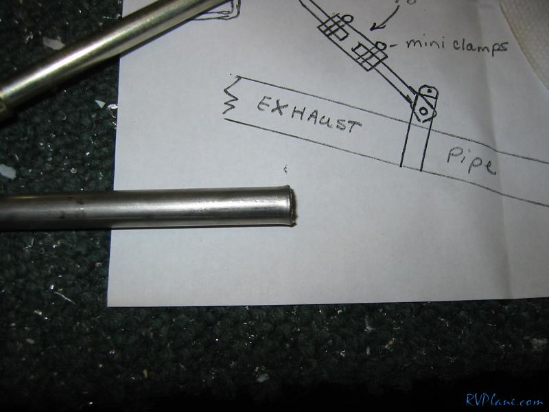

Only problems thus far was the oil door popping open on the first flight. I made it out of Aluminum and it flexed too much and the latch let go. I added some .063 angle heavily fluted to the underside and it's been fine ever since. The second thing was the exhaust hangers slipped off on one pipe causing a few min of anxiety as the pipe rubbed on the cooling ramp. Sounded like something was not right for sure and I quickly landed and found this when I de-cowled.
Andy,
The solution to prevent this from happening again is to slightly flare the end of the stainless steel tube that go into the hose. When you apply the hose clamps to the tube, make sure the clamps are over the slightly flared ends of the tubes. The slight flare causes the exhaust hangars to be not easily separated from the rubber hose.

If you have access to these (Parker Beading tool set), use 'em.
Otherwise flair like Mike says.

That's incredible! You keep that building pace flying it. Regarding those loose hose/hangers I used Dremel to notch the stainless for better rubber grip. Saw the trick on VAF maybe even on your RV9A site
