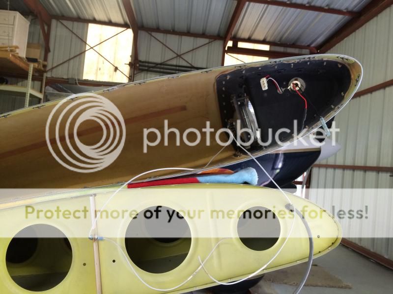

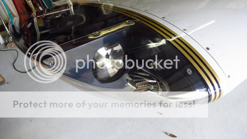

So I finally bit the bullet and sprang for the new Whelen wingtip/tail LED light kit sold by Mike Stewart. I got the one that goes under cover. Here's what I had before:

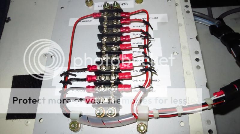

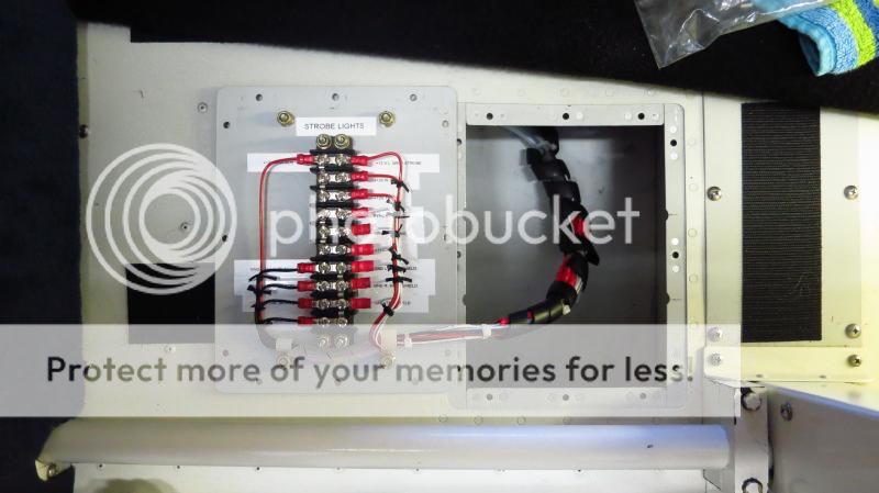

The most difficult part was pulling the old Whelen power supply out of its location in the baggage floor:
...and rewiring it thus:

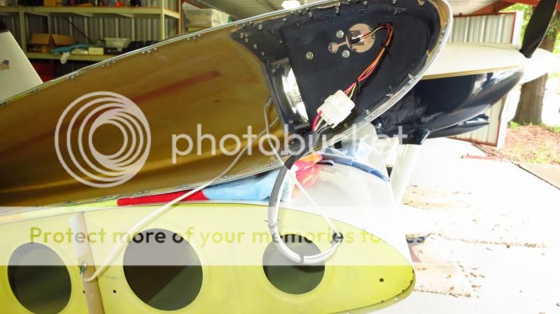

I got rid of about 2 pounds by removing the old power supply. Not to mention the much greater current draw with the old system. I was able to use the original 3-conductor cabling from Whelen although Mike sells the new lightweight 4-conductor cable if you can pull your old wires out. For me it was just easier to use what was already there. I did have to change from the Whelen connectors to some 4-pin Molex connectors that I had on hand. Here's the old:

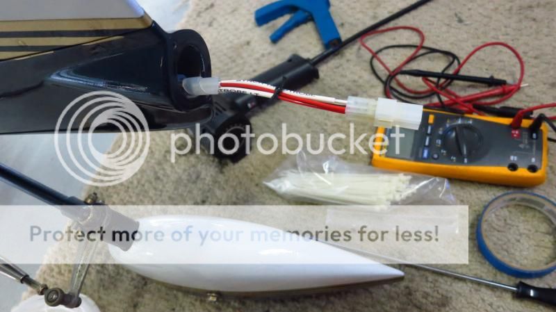

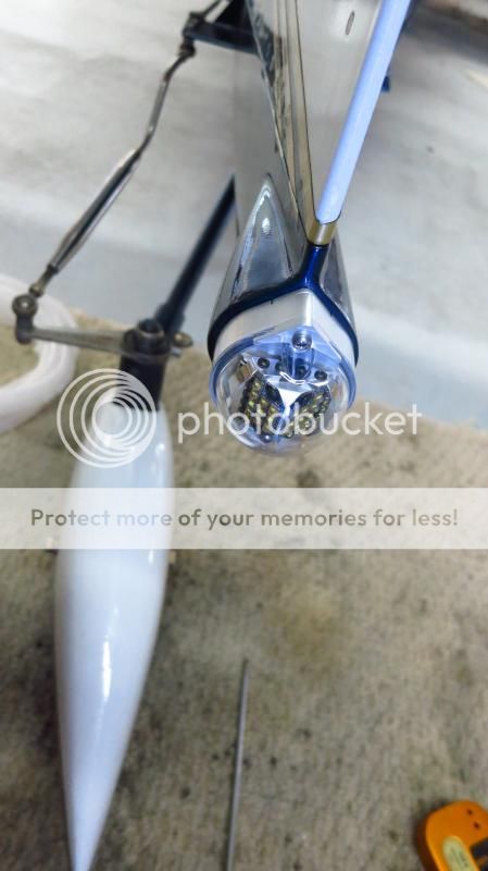

For the tail, I had to convert to the 4-pin Molex connector as well. This one worked well:
I also had to take a Dremel sanding drum and open up the hole just a little to accommodate the larger tail strobe/nav light. The old mounting screw holes matched up perfectly with the new unit:

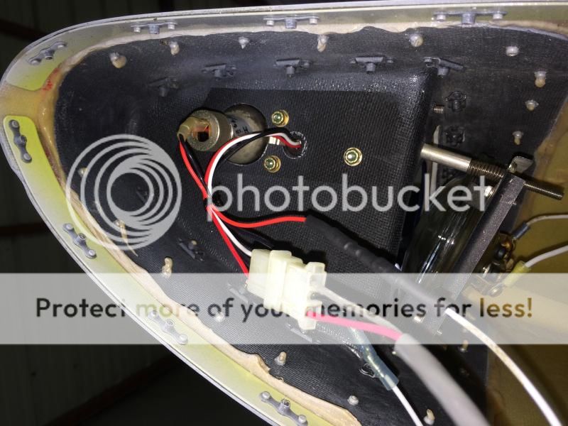

On the wings I used a similar Molex 4-pin connector that I happened to have on hand:
Existing holes in the wing matched up perfectly with the new units as well. You can pretty much do the whole job in a day, but I split it up into several shorter sessions while waiting for the new lights to arrive. Here's everything put back together:

I think this upgrade just moved up a few notches on my must have list.
I like the way you did the jumper block to replace the old power supply. Do you happen to have of schematic of the electrical connections or a picture of the jumper block that clearly shows the labels?

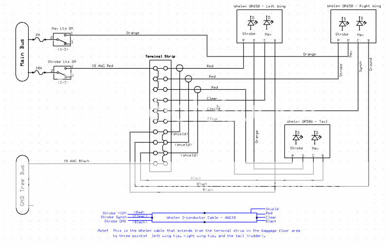

Rick,
Here's the schematic. Not sure how well it's going to show up as a .PNG file, but if you like, send me your email and I'll send you the file. It's an ExpressPCB file, if you happen to use that CAD program. Or I can send it to you as a PDF.
Here's a closer photo as well:
Click on the images and they will get quite large for you.
Also, let me add that the original Whelen cable is shielded. I don't think you really need shielded any more with LED lights, but it can't hurt so I went ahead and grounded the shields at the terminal block just for grins. Most people won't need to do that.

Old 09-26-2014, 04:05 PM
Rick_A's Avatar
Rick_A Rick_A is offline
Posts: 1,519
Default Thanks
Thanks Pat, I was able to print them at 125% and they look great.
