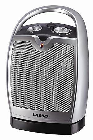

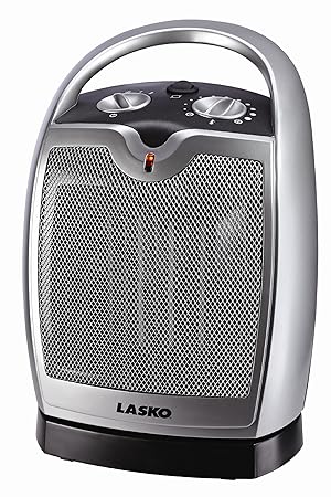

I live in Hartford where the winters aren't horribly cold, but I always find somewhere interesting to fly when it's 0-10F (i.e. Alton Bay). I place a 750/1500W ceramic heater in the baggage compartment. This Lasko 5409 is a newer model than what I have but has the same specs. I like to pre-heat the cabin so the LCDs aren't as cold-soaked... PLUS my other half enjoys the seats and headsets being softer and warmer. This has worked well for 5 seasons.
I like this ceramic block style without hot exposed wire heating elements. Even if it tips over for some reason, it won't burn anything. There are two levels on the heater; I use the 750W setting, no oscillation, and set the thermostat to relatively cool. I turn this on with the engine heater at least 3 hours prior to flight; it hits about ~50-60F before the thermostat kicks in.
