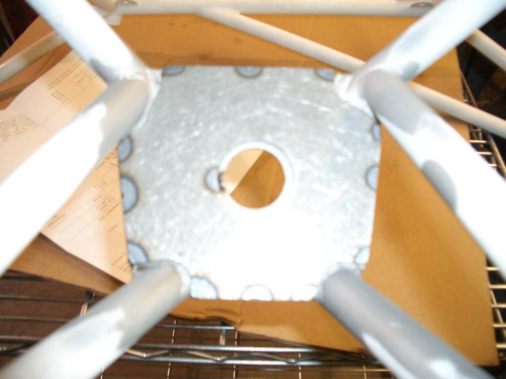

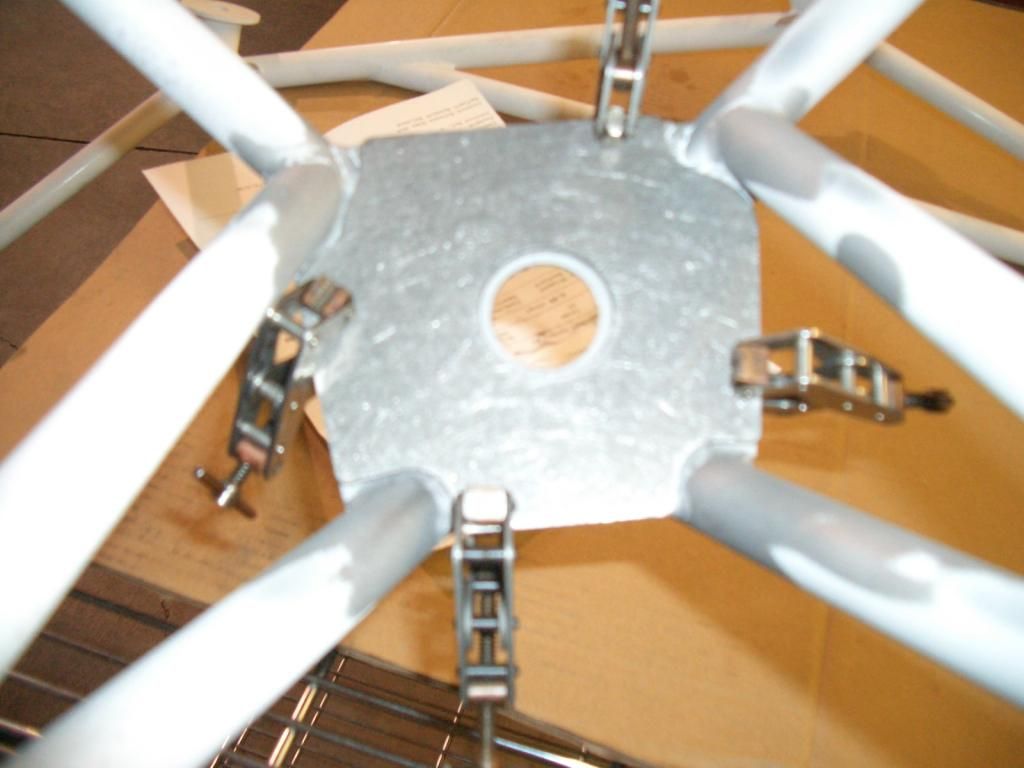

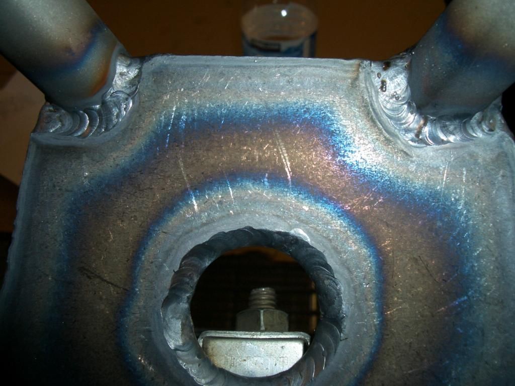

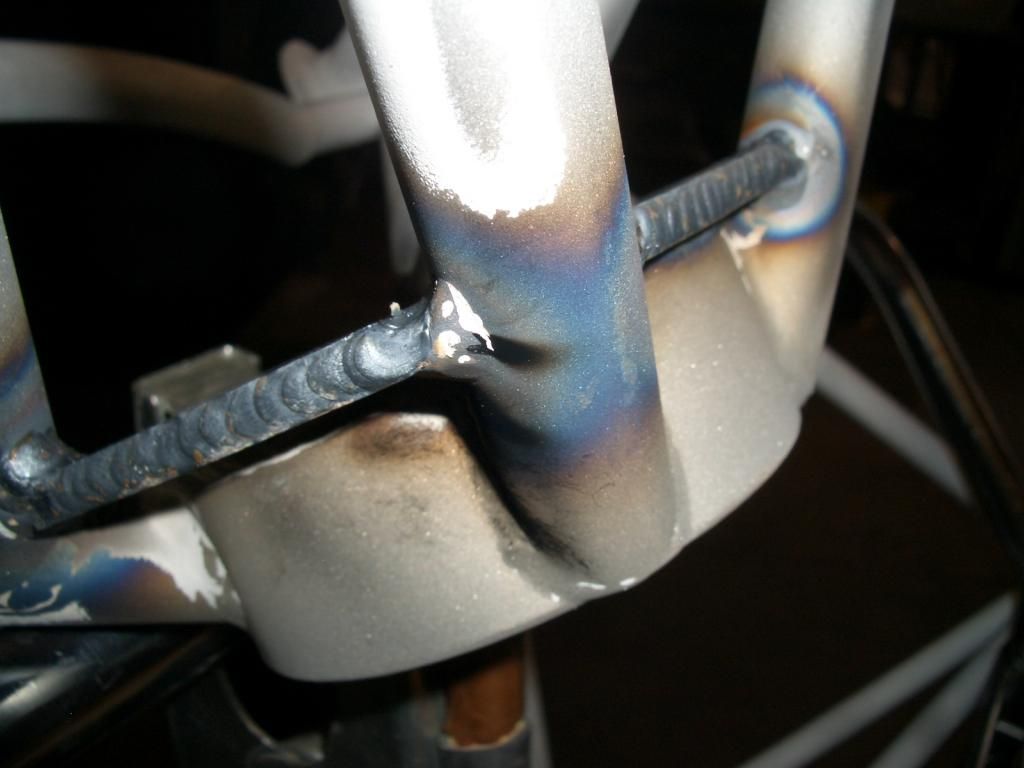

SERVICE BULLETIN 14-08-29
Well guys, My 10 isn't finished so this repair was simple! Sandblasted the mount first, ground the plate to fit. Then clamped in the plate. I used to be a certified aerospace tig welder, so that part was easy! About 20 minutes of welding! The main suggestion I can make is that when you do this repair, remove the mount I've welded a ton of precision parts and I wouldn't be able to do a nice job of the welding if I couldn't lay it on my welding table. Second I suggest welding the entire plate so as not to leave any airspace between the plate and the existing mount- This would be an area of concern for corrosion! Finally a re-powder coat! I agree with others that glue, silicone, or other adhesive is not really suitable for a repair of this importance! Just my opinion!
