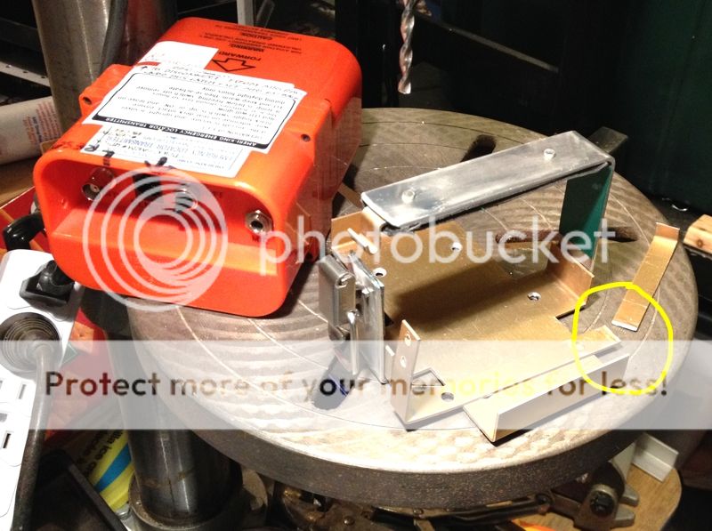

Hi Folks,
after about 8 years, and about that many removals, the little 1/2" metal strap that retains the ELT broke at the sharp bottom bend ( circled). This was a very sharp angle, in some quite soft stock....
Before you think I'm a total newb, you HAVE to bend this out of the way to lift the ELT clear of the base retainer tabs.
As you can see, I made a 1" wide replacement strap from 5052 I had around, with the grain running the long way, and re-used the latch, although there's likely a better way. Yup, got to drive 4 rivets even!
[IMG][/IMG]
now the worse news....AK is still using this strap on their new $700 and up 406 ELT's!

Originally Posted by flyboy1963 View Post
Hi Folks,
Same happened to me last year during condition inspection. I made two straps from old cargo straps (reuse of ones I used to pull down the fuselage skins during build) that I can tighten down snugly with a wrench. My ELT is located on the side wall in the baggage area behind the passenger seat. Good thing with fabric straps is when working inside fuselage I can take the ELT out and the straps are removed and not have the metal straps in the way.

Time to eat a little crow.....
the local avionics guys did the checks, and found my AK 121.5 ELT was nearly dead, and U/S.
I'm SOOOOOOOO glad I spent all that time making a new bracket for this P.O.S.
it put out .09 watts, just enough so that it fooled me when I did the manual type 'shake' test, and activated by the remote switch!
So here's another nail in the AK coffin; an ELT that's just sat in the dry mild interior of a plane for 8 or so years, and 110 hours of flight, is toast!
