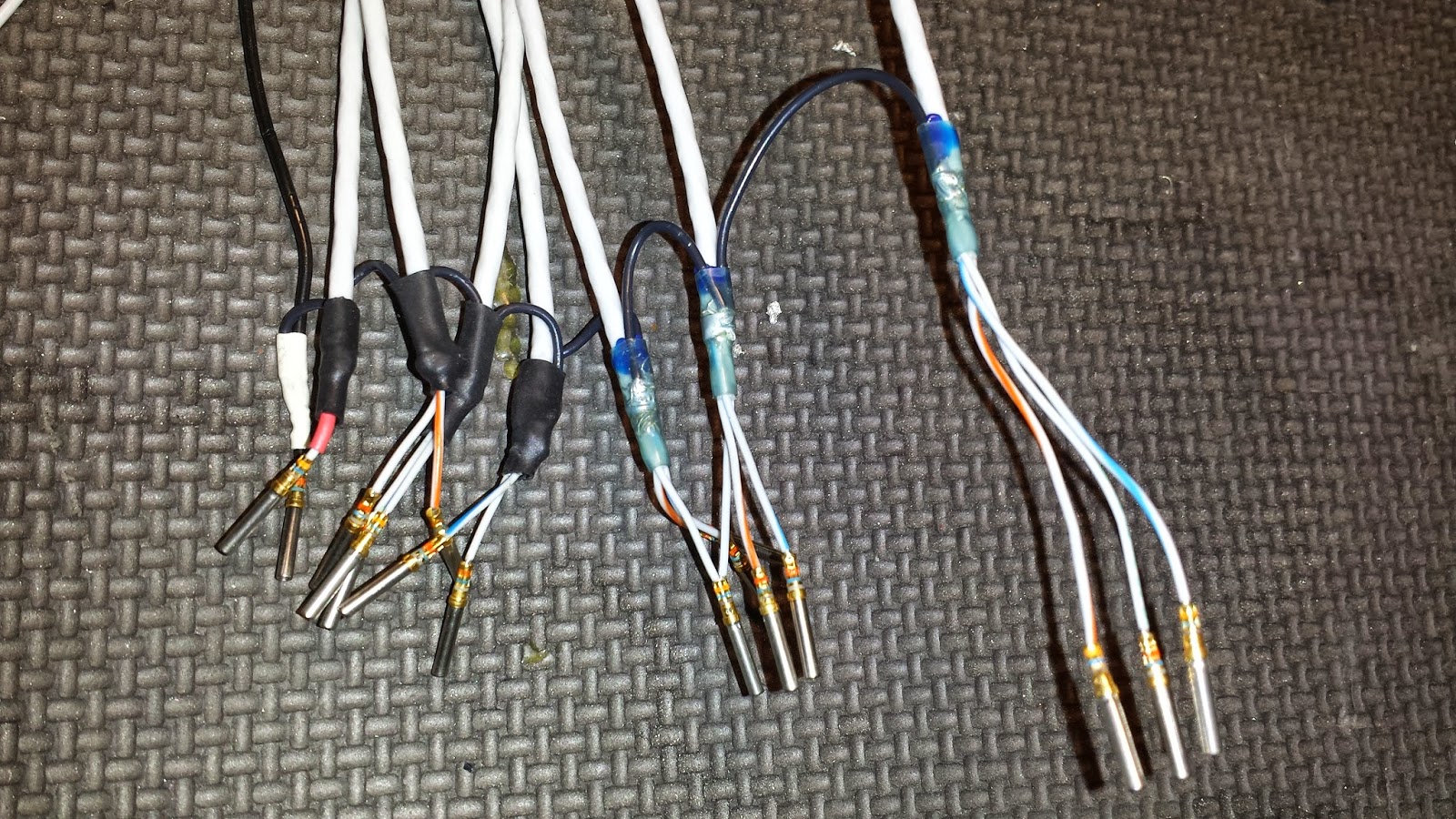

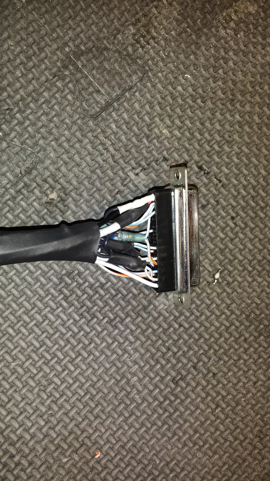

I see a ton of wire heading to the dynon intercom, with many grounds. Anyone have a picture of how they got all that wire connected?

http://4.bp.blogspot.com/-Wzvcy1iT9w...017_082926.jpg
http://2.bp.blogspot.com/-rPbNrNR4Zb...019_111643.jpg

I hope this is what your looking for.

If you use this style of Mil-Spec back shell with a flat clamping area it will be easier getting all of the wires and ground daisy chains in.
The hardest part may be remembering to slip the one-piece back shell over the bundle before inserting the contacts into the connector.

Default Perfect!!!
Thanx guys!
This is exactly what I needed.
Now, just make it work for me...
