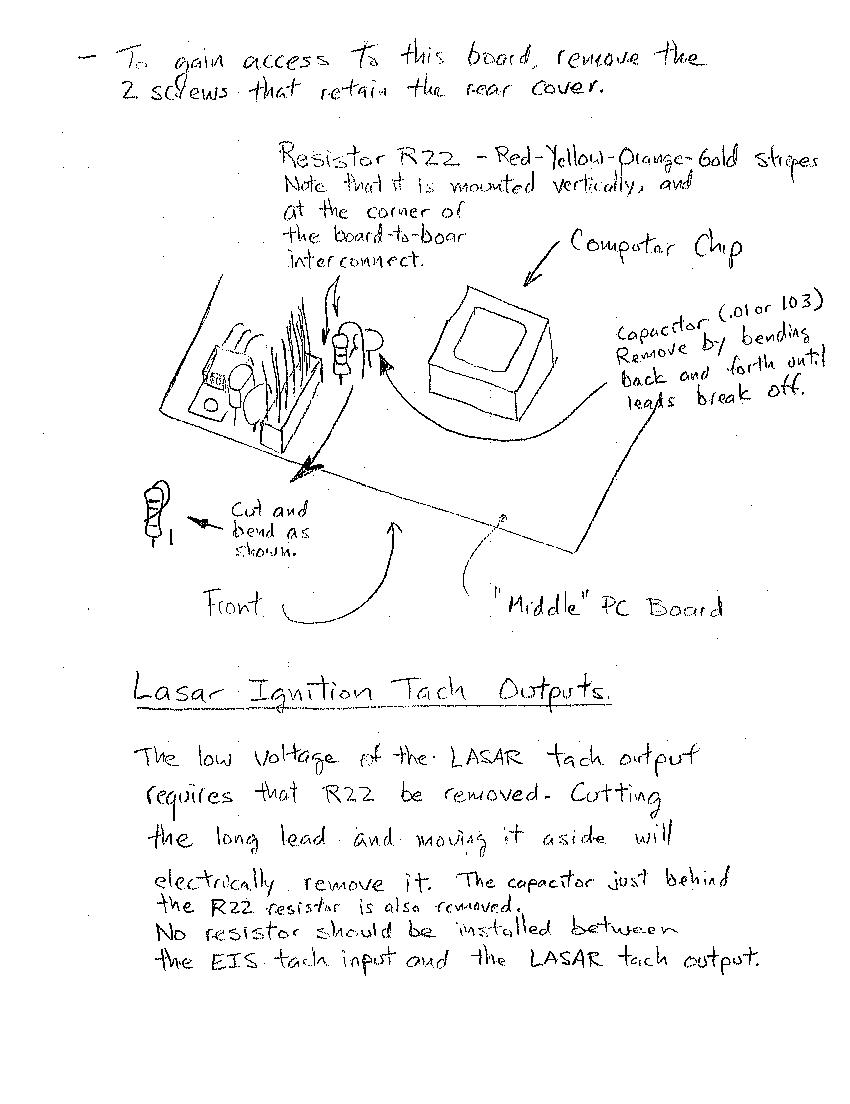

I'm working on a -8QB, O-360-A1D with an E/Pmag combo with a GRT EIS 4000 engine monitor.
Did the first start today (much rejoicing, yeaa) and the tachometer read 0, zilch, nada. The Emag manual says the factory default tach output is 2 pulses per revolution, so I had previously set the Configuration Set (TachP/R) page on the EIS to 2. The wiring seems straightforward enough, yellow wire from the EIS to the #6 hole on the Emag control plug. The Emag manual also mentions the ability to change the output to 1 pulse per rev, but doesn't mention how to do it.
Weird. Has anyone seen this before? I'm going to call both GRT and Emag on Monday and see what they might have to say, but thought I'd check and see if anyone here has any ideas.

I believe that you need to call GRT. The Emag tach pulse is low voltage (5v IIRC), the EIS is expecting to see a mag pulse of ~ 300v. I think the basic problem is that the Emag is talking too quietly. I have heard of people having to snip out a couple of resistors from the EIS board to make the sensing circuit sensitive enough - I don't know which ones, that is why you need to call GRT, and it was over a year ago so there may be another fix. Emag may also be able to put out 12v, don't know if that is of any use to the EIS.
So, I think you have a I/O incompatibility problem, with the EIS the easiest to fix by increasing its sensitivity.

It was a pretty simple job, just as Pete described; open up the EIS box, clip a resistor and remove a capacitor from the middle circuit board. Easy!
Worked like a charm; cranked up the engine a couple of times today and the tach works fine. Need the drawing?

This 10 minute modification works with both P-mag/E-mag and with
LASAR ignition. I know because I've used it with both, even though the
document indicates LASAR only. It was written pre-P-mag/E-mag.
http://www.rv7-a.com/Lasar%20Tach%20Mod.jpg
