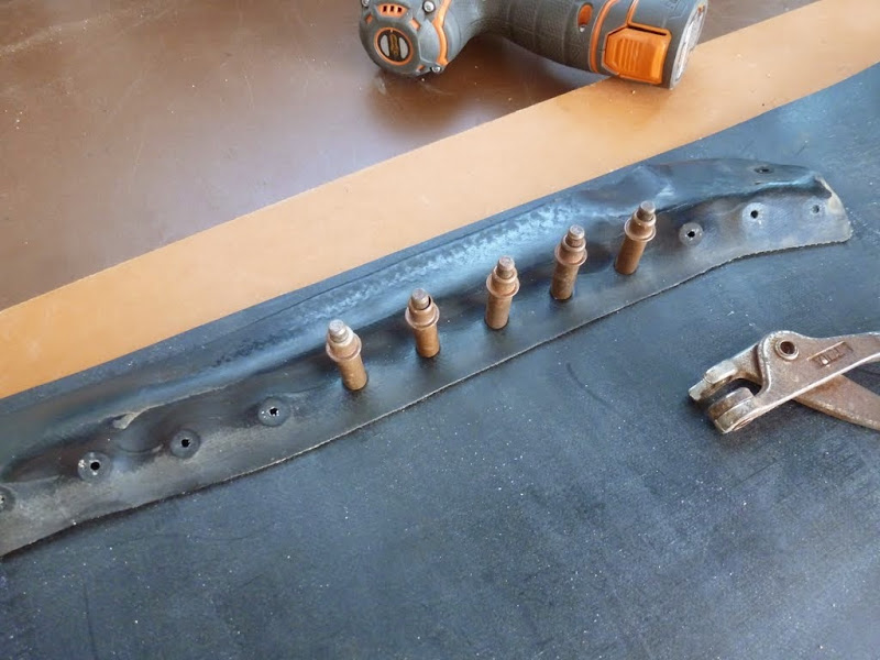

Baffle seals age slowly, and the effects of temperature and wear change CHT?s a little bit over a long time. Season after season passes, we go from winter to summer over and over again, and the overall rise in temperatures goes un-noticed until one day you realize that you?re compensating with increased climb speeds on every flight. Suddenly, you realize that the seals have been doing their duty for close to a decade and it is time for a re-do! Such was the case with the Valkyrie, my 1800+ hour RV-8?.so last weekend I decided it was time for new seals. As most builders remember, cutting and trimming baffle seals takes time and a lot of effort ? not something we remember fondly. But I?ve got good news ? replacing existing seals can be quick and easy! Here are a couple of notes from my project ? which really only took about five hours.
Crinkly! Yup ? these seals have taken a set and are heat checked ? ready to replace.
Use a center punch to pop the mandrels out of the pulled rivets ? a few clicks and they?ll come out with vigor!
After pulling off the old seal, use a sanding disk to grind off the shank ? sand it down flush to the baffle aluminum.

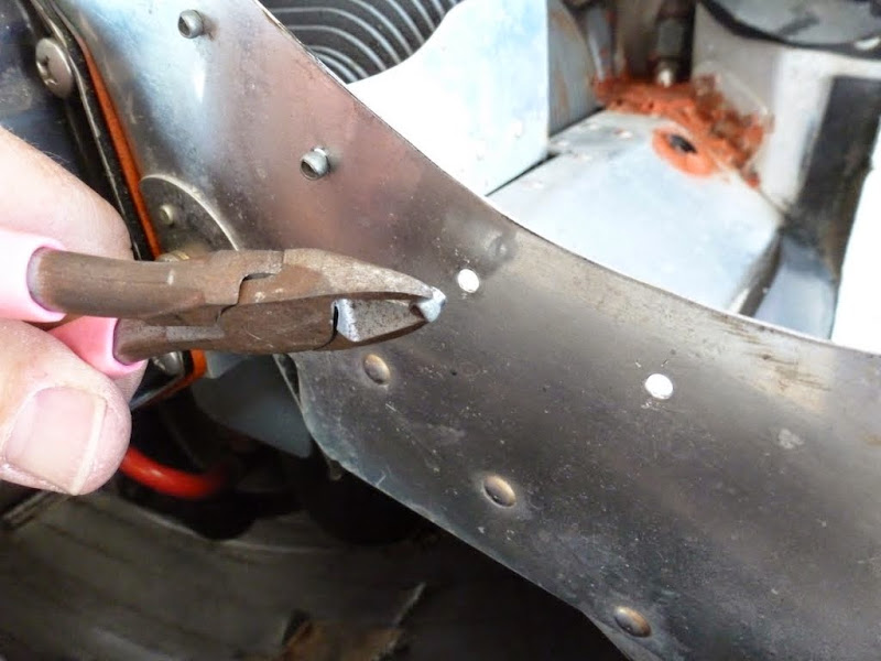

With the shank ground down, pull the tail off with a pair of dikes ? the holes will still be perfect!
Take each segment off one at a time. Lay them on the new material on top of a sacrificial wooden surface, then drill through the holes and cleco to the surface. Press down to flatten and cut with a new razor nice ? and the new piece will be perfect ? ready to remount.
