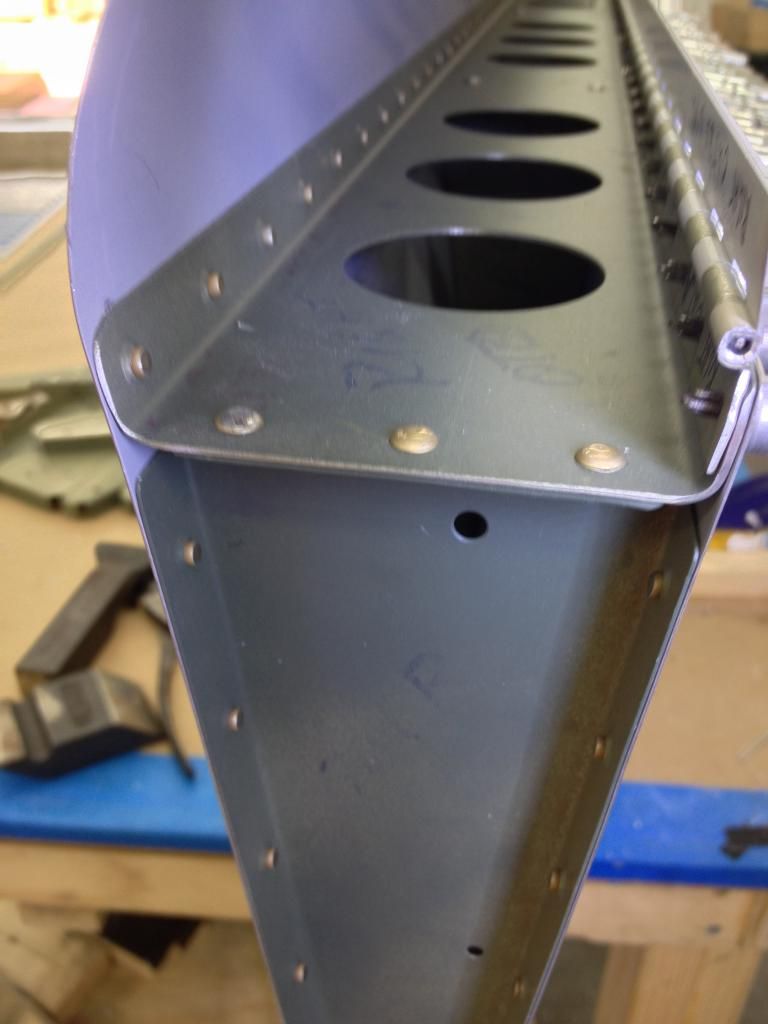

This weekend I came across one of those times where it seemed obvious that I should depart from the plans. Building the flaps (RV-7), and drawing 14A Section C-C clearly calls for pop rivets (LP 4-3s) for joining the ribs and the spar. That makes sense for the inboard end rib and all the interior ribs, there's no way to buck rivets there, but not for the outboard end rib, FL 704. That joint is wide open top and bottom. I couldn't see any rationale for not using driven rivets, so that's what I did. See pictures below.
Did I miss something, or is this just one of those things?

Originally Posted by Iluke View Post
I'm not familiar with the CFD model. Could you explain?
CFD = Computational Fluid Dynamics.
But Dan was just being silly. You made a good choice going with the solid rivets. Carry on.

Sorry Ivan, I stepped out to do errands and then went to the movies. But Kurt is correct, just some humor. Nice job on the rivet selection.

My quick build had solid rivets there so they must be ok.
