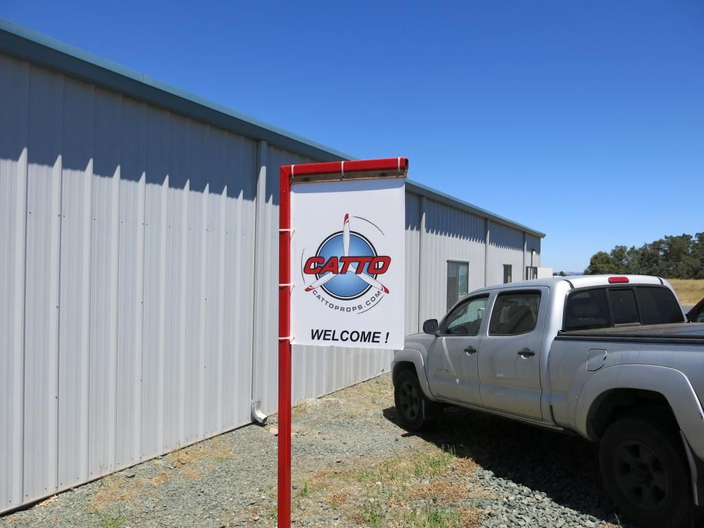

We tied up and took a short stroll to the east end of the airport where we found the Catto facility:
They had a nice BBQ and drinks for all who threw in $10 but the best part of the trip was poking around.

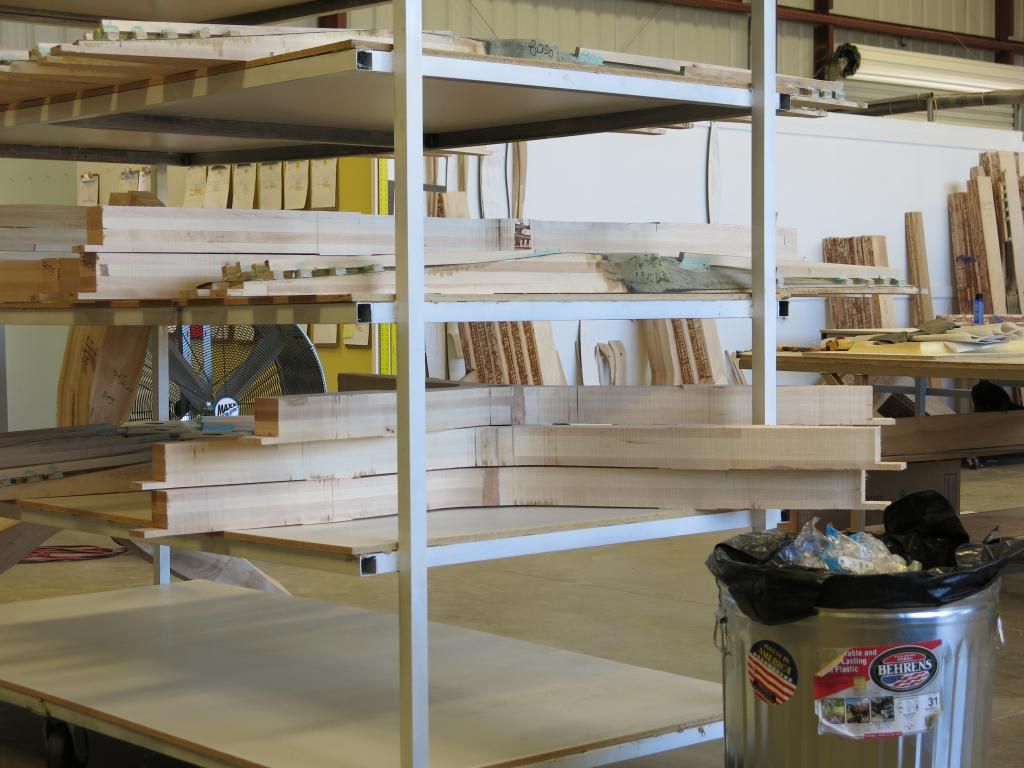

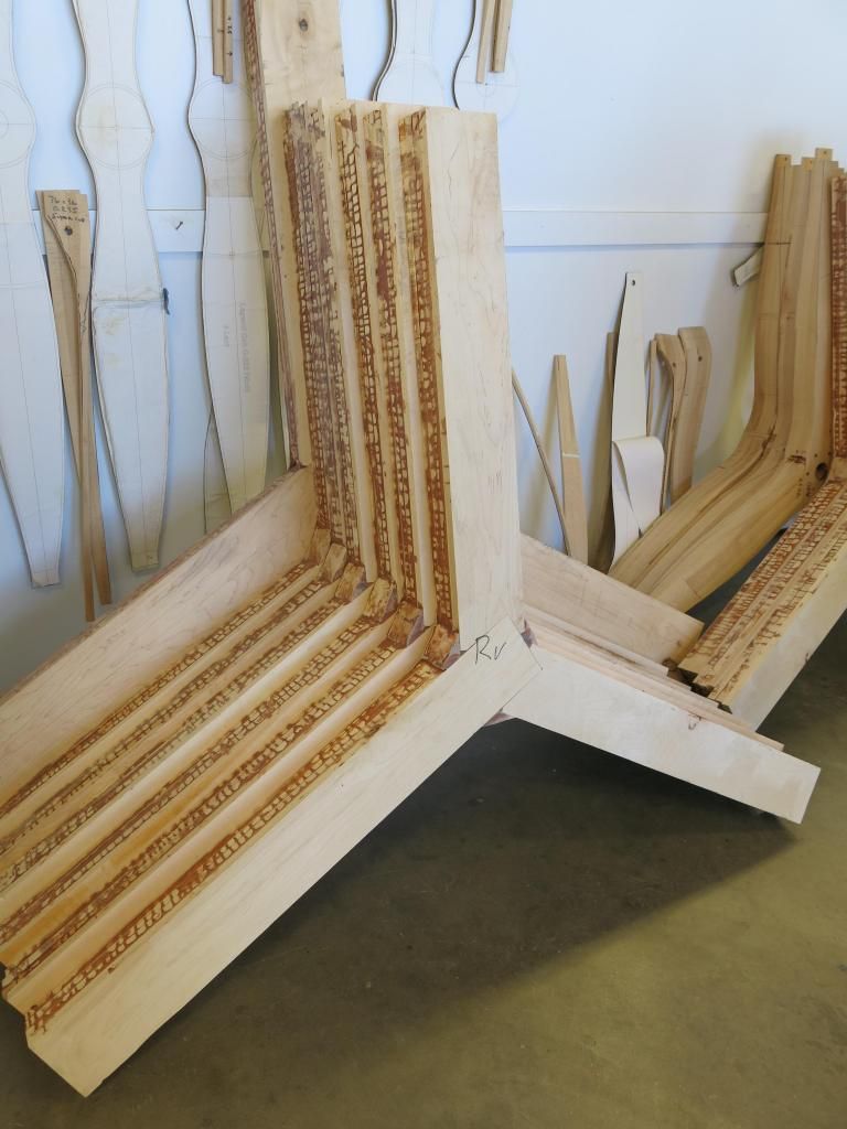

Here are some future three blade props that have been glued together. On the wall behind them, you?ll see some two bladed patterns. I heard that the pattern is transferred to the blanks and rough cut on a band saw. To the right of the picture, you?ll see some rough cut three bladed props:
Here are some props after being rough cut I assume:

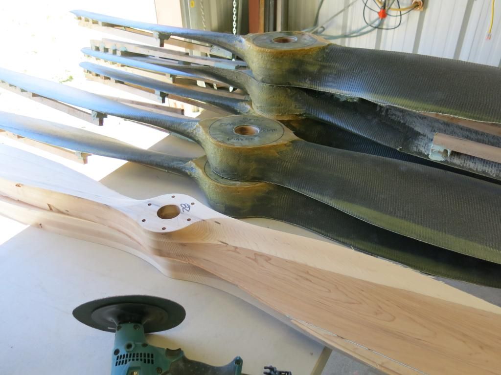

The wood is first covered with carbon fiber cloth. Here are some two bladed props that are curing. Evidently they employ guard flies to watch over the cure. If you look closely, you'll see one on the job:
I?m finding out that woodwork requires a lot of hands on labor. I visited the Fender Guitar Factory recently as well and there seems to be a lot of similar processes: gluing, sanding, cutting, more sanding, more smoothing, etc. The props need a lot of sanding filling and smoothing along the way. The next layer is fiberglass. These are ready for more sanding with a low tech tool:

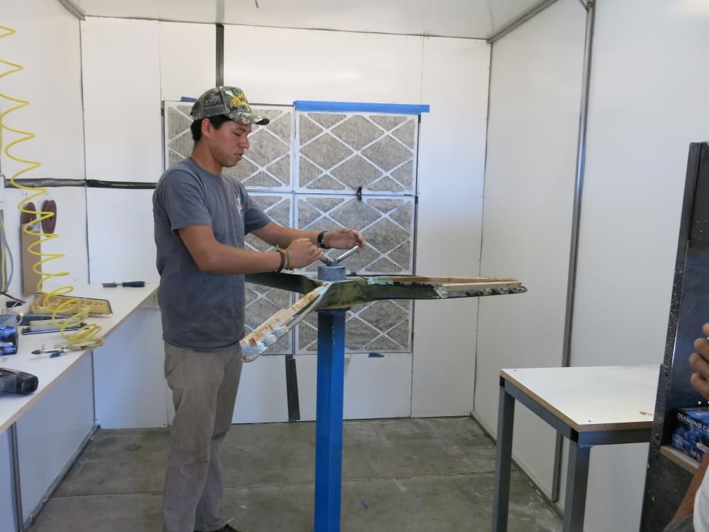

Here one of the workers demonstrates a fixture that holds the prop during prep:

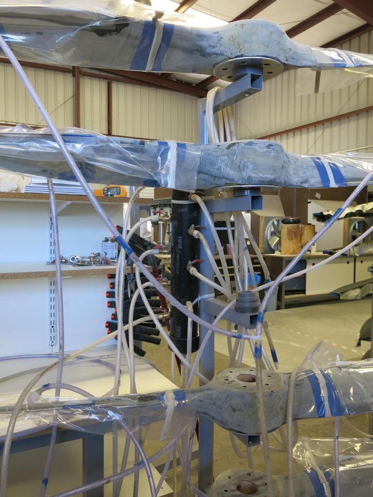

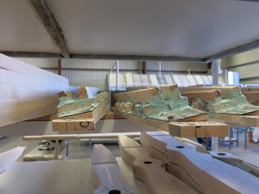

So, in order to protect the props while flying in the rain, you can add nickel leading edges. I really thought that the prop was routed for the installation of these because the fit is so perfect but they are glued on. Then they are vacuumed bagged while the glue dries:
There is some filling and more sanding. I believe these props are in for repair. You can see the peel ply on the leading edges of some of them:

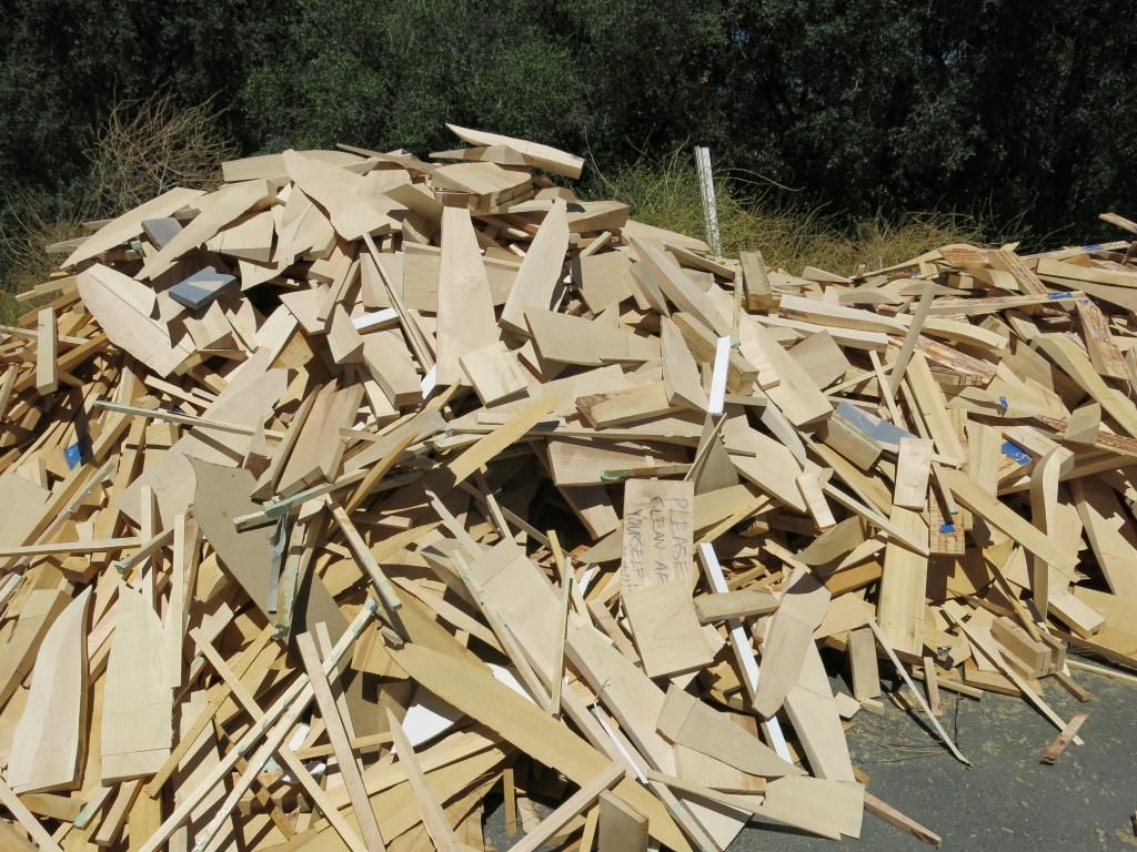

Here is a pile of scraps:

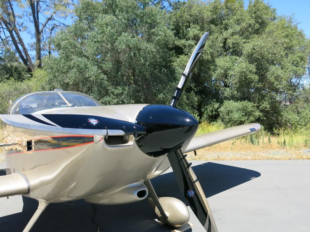

In that picture of the 3-blade mounted on the RV, it appears as those are fences to stop span-wise flow. I'm totally dense when it comes to figuring out fluid dynamics so I can't even begin to guess at the effect such devices might have. Even with those "protuberances" that's one heck of a pretty prop.
