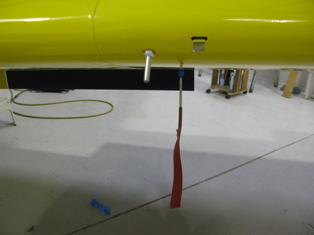

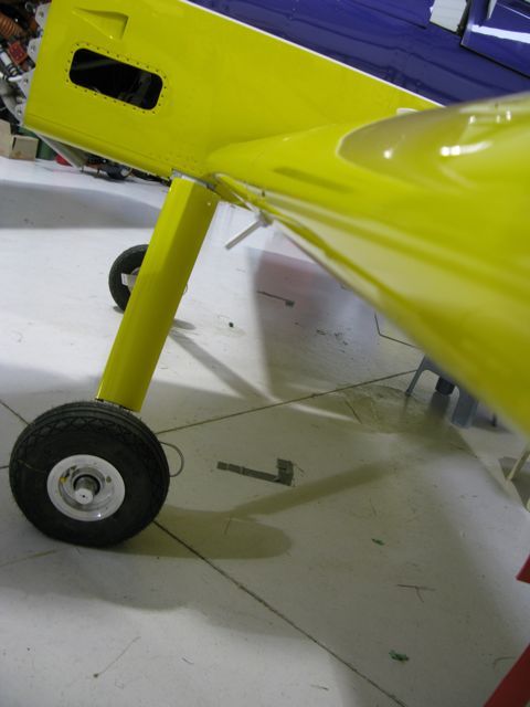

I started off making my AOA probe from a tire valve, just cut off the rubber and silver soldered on a washer to fit inside the wing. Would probably have worked with a thin nut on the outside.
I later decided to have a friend machine a longer one in aluminum (lower pictures) to get outside the boundary layer.
Works great...
