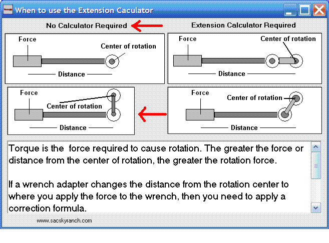

Originally Posted by Joey
Your A&P friend is correct.
I don't want to sound rude, but there is some very dangerous advice being given in here. Advice that could lead to people improperly torquing their propellers.
Absolutely incorrect. The angle does matter. If you require proof, this link does the math to demonstrate.
PLEASE be more careful with this stuff! I hope Dan sees this and adds a caution to his calculator that the values given are only accurate if the extension is kept inline with the tool.
So lets say your torque wrench is set for 100ft lbs. Are you telling me that if I apply 100 ftlbs to the end of the extension with the wrench at zero degrees, it will be a different torque than if applied at 90 degrees?
I need to think about the math but intuitively the wrench is applying 100ftlb at the end of the extension no matter what the angle....
Probably a moot point ayway because I why would you use anything other than a straight wrench when torquing the prop bolts?
Either way,I believe the origional assertion was that if you applied the Twrench at 90 degrees to the extension then you could ignore the extension...This is definatly not true.
Frank
Yes. Anthing other than 90 degrees will change the mechanical advantage.
I can see how it would appear so, but once you do the math it becomes clear.
I do it every day. Sometimes that's what it takes to get in there.
Frank
It's 100% true.

Originally Posted by RVPilotDotCom
So it is with the addition of the crows foot, it's like adding a mini cheater. It will cause a small increase in torque that has to be compensated for in your computations.
Only if it adds the effective length of the tool. A crow's foot oriented 90 degrees to the wrench does not add to the effective length and adds no mechanical advantage.
Sorry Frank, but you need to go back to physics class.
CASE 1 - extension in line with torque wrench
Let's assume you have your torque wrench set to 100 in-lb. Let's assume the distance between the hand grip and the square drive for the socket is 10 inches. If you put a socket on the wrench, and put it on a nut, you'll need to pull on the hand grip with a force of 10 lb to create a moment (torque) of 100 in-lb.
Now, let's imagine that you have an extension that is two inches long. You mount the extension so that it is aligned with the axis of the torque wrench, so the end of the extension is now 12 inches from the hand grip on the wrench. You put a socket on the extension, put it on a nut, and pull until the torque wrench clicks at 100 in-lb. How much torque have you put on the nut? The torque on the nut is the sum of two things:
1. The torque wrench applied a moment of 100 in-lb to the extension, and this moment is reacted at the nut.
2. You pulled on the torque wrench hand grip with a force of 10 lb, and this force is reacted where the torque wrench is attached to the extension. The 10 lb of force on the end of the extension creates a torque at the nut of 10 lb x 2 inches = 20 in-lb.
The total torque applied to the nut = the sum of 100 + 20 = 120 in-lb.
CASE 2 - extension at 90 deg to torque wrench
The 10 inch long torque wrench is still set to 100 in-lb. But now the 2 inch long extension is at 90 degrees to the torque wrench axis. We put a socket on the extension, put it on a nut, and pull until the torque wrench clicks at 100 in-lb. How much torque have you put on the nut? The torque on the nut is the sum of two things:
2. You pulled on the torque wrench hand grip with a force of 10 lb, and this force is reacted where the torque wrench is attached to the extension. This force is transferred through extension, and is reacted at the nut. How much torque does this force create at the nut? Well, the force is actually aligned with the axis of the extension. This is just like putting a wrench on a nut, and then pushing on the end of the wrench so that the direction of the push is directly towards the nut. You can push as hard as you want, and the nut won't turn, as the axis of the force is directly through the nut. The distance between the axis of this force and the centre of the nut is 0 inches, so the torque = 10 lb x 0 inches = 0 in-lb.
The total torque applied to the nut = the sum of 100 + 0 = 100 in-lb.
