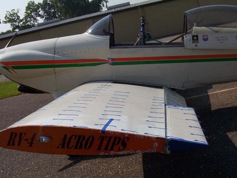

http://i614.photobucket.com/albums/t...psfc8f62de.jpg
I have read with interest the posts about using wing tufts and watching the airflow during stalls and spins. Attaching the yarn tufts is really simple with about 1 inch per tuft of the blue painter’s masking tape. Didn’t lose any of the tufts during the testing. I posted three video clips in http://www.youtube.com/user/willyeyeball/videos
The upright spin to the left gets all the yarn tufts dancing. I also did aggressive accelerated stalls in approximately an 80 degree bank at 110 knots, and it stalled with 3.5 Gs. The tufts looked exactly the same during the stall as the level flight stalls so I didn’t video record them. As previously discussed, the ailerons are still effective during the stalls. It was also interesting to watch the turbulence around the aileron and flap juncture.

Aerodynamics taught visually --- will save to show my students!

Thanks for posting your work. Yes, is not what I would expected for flow over the aileron and the flaps too. Maybe the aerodynamicists will enlighten us.

Great footage. Great to see the tufts reattached in a split second on spin recovery. Thanks for posting.
