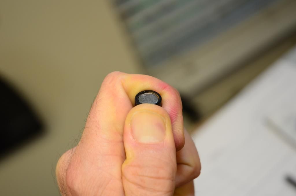

Began to back rivet my tail cone j-channels the other day and was really having fits with getting a well driven shop head. It was seriously slow going as each rivet was done methodically in an attempt to get a square shop head. It was almost as if getting a square shop head was a totally random event. This pic is indicative of the results. Frustrating...
After a bit of searching, I came across this thread posted last year by Mike Lauritsen:
http://www.vansairforce.com/communit...ght=back+rivet
Sure enough, upon closer inspection, you can see a small nub in the center of the set. More critically, the set is slightly concave - not flat - with the center being slightly lower than the outer surface. Fairly tough to see in the pic:

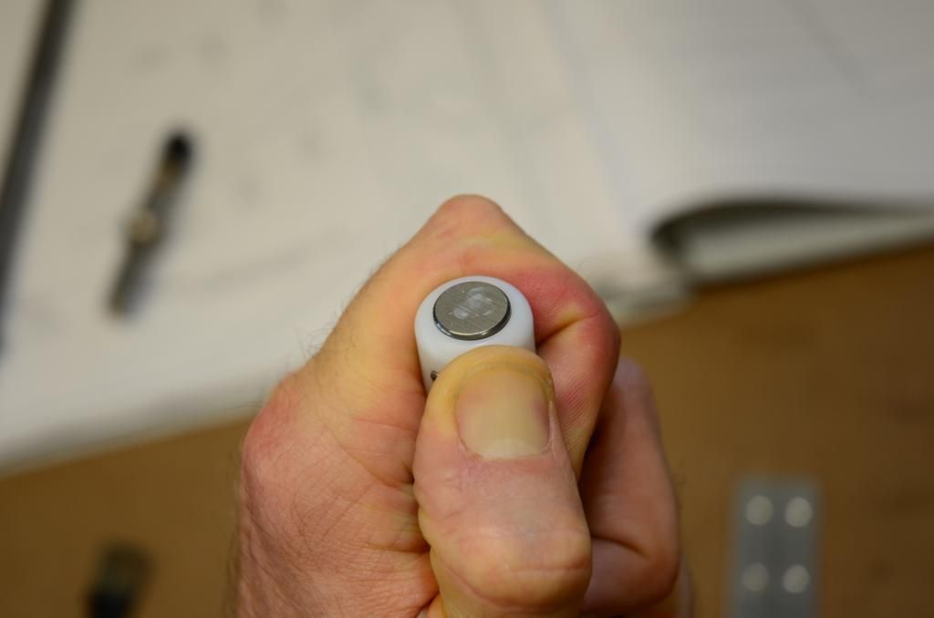

A quick order to ACS yesterday had this on my porch this evening - definitely flat:

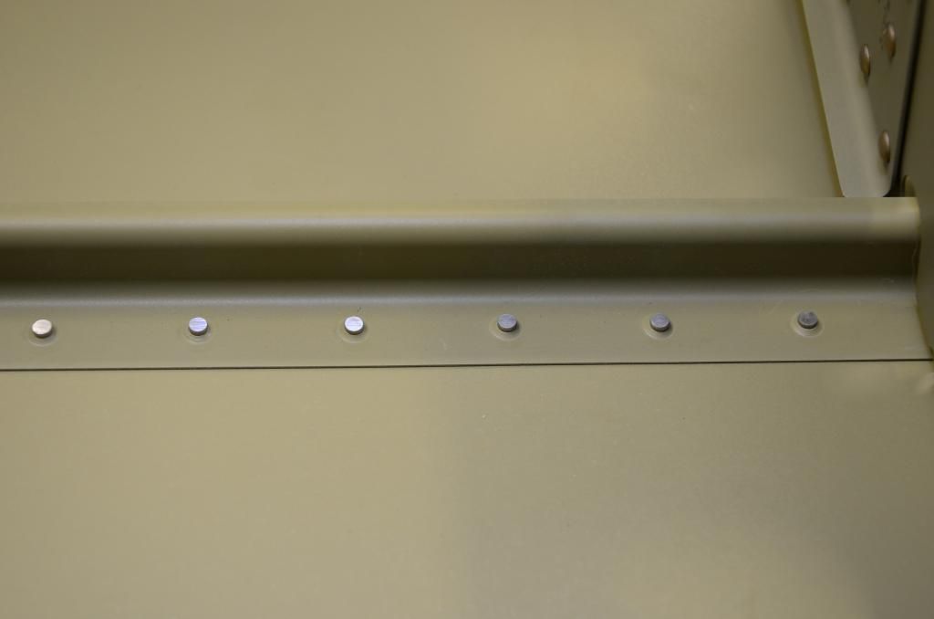

After a few practice sets, I did this row in quite a hurry to increase the odds of not being perfectly square:
Much, much easier to get a square shop head! Yes, technique and skill still have a huge role, but if something just seems a bit off-kilter, don't discount an equipment issue.

Not much slop noticed, Robert. I received my replacement today - no nub and a flatter set. I will definitely use the set with the thicker collar when able.
